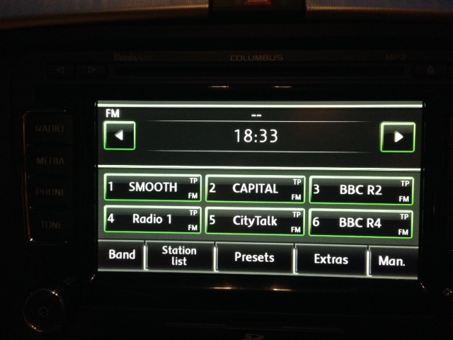

The Columbus in my 2011 Superb Elegance CR170 has a frozen screen. No sound from the unit at all, and no response from any controls or from the touch screen, nothing seems to work. I have tried pressing < > and the button to the right of the CD eject button and I've gone though the 'reboot' procedure several times, but no joy. Is there anything else I can try? Many thanks!

Thanks for the quick response. The screen does switch off when the ignition key is removed etc. When the ignition is switched on it comes on with the 'Welcome to Skoda Navigation' or whatever, then goes to the screen I attached the photo of (radio stations etc) but pressing any of the buttons doesn't do anything.
it sounds like its possible the navigation data is corrupted on the HDD or the HDD itself is acting up. If you have a map DVD you could try turning the unit on, and inserting that. The columbus will then read the DVD for navigation data.
