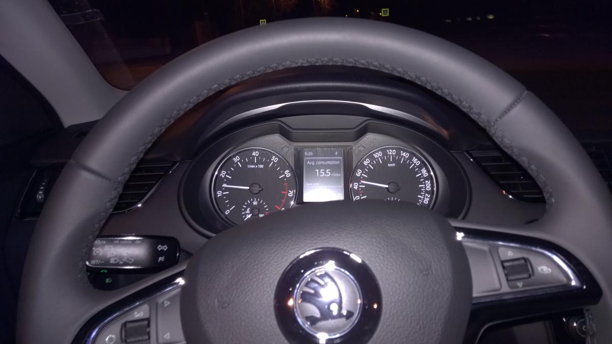

So today before going to work i made a test. Start up the car. Center the steering wheel and then do full lock to left and right. To right it was about 1.6 turns (one full turn and little bit over half till full lock). To left it was about 1.7 turns. Took a picture aswell. Perfect road. Straight one barely any camber to right. Car runs good. Runs straight as an arrow when steeringwheel is bit left. Column lock activates nicely. While activation steeringwheel doesnt move or do anything. It just locks. Sorry for bad quality of the picture.
Looks wonky to me!
Is the wheel as per the picture when the column lock is on, or is the wheel centered (you would drive to the right slightly)?

Every Skoda I have ever owned (3 - Fabia vRS estate, Mk2 Octavia vRS estate and the MK3) has come with the wheel ever so slightly off centre, my MK3 Octavia is the same, slightly off to the left...enough to notice but not really annoy.
Having had a v bad experience with a VW main dealer a while back correcting the wheel offset on a Golf Bluemotion I've been inclined ever since to just leave it be. I might get the alignment done at some point to resolve it but given the car tracks straight and true and isn't wearing tyres in an odd fashion going to leave alone for now.
To be fair your offset does look worse than mine though and would probably irritate me too (as I have mild OCD).
There is a slight offset and then there is this issue, it has clearly been put on wonky!
Get them to sort it and for the record mine is dead straight.
It looks like the steering wheel has been put on a few splines out rather than the tracking being off to me.
Another theory. They or various delivery drivers could have hit something, ie a curb, pot hole etc. Replaced the wheel & had the tracking corrected (badly). But they haven't checked the steering wheel position in the mad rush to do it before anyone saw it. Could be wrong though.

Steering wheel is at same position when the lock is engaged. When on tghe move i correct the steeringwheel to center, cars starts going to right, not badly, but enough to not do it on the higher speeds. I don't belive that factory person wreck the car or something on the curb.  When i got the car it had only 4km on the clock (factory testing ?)
