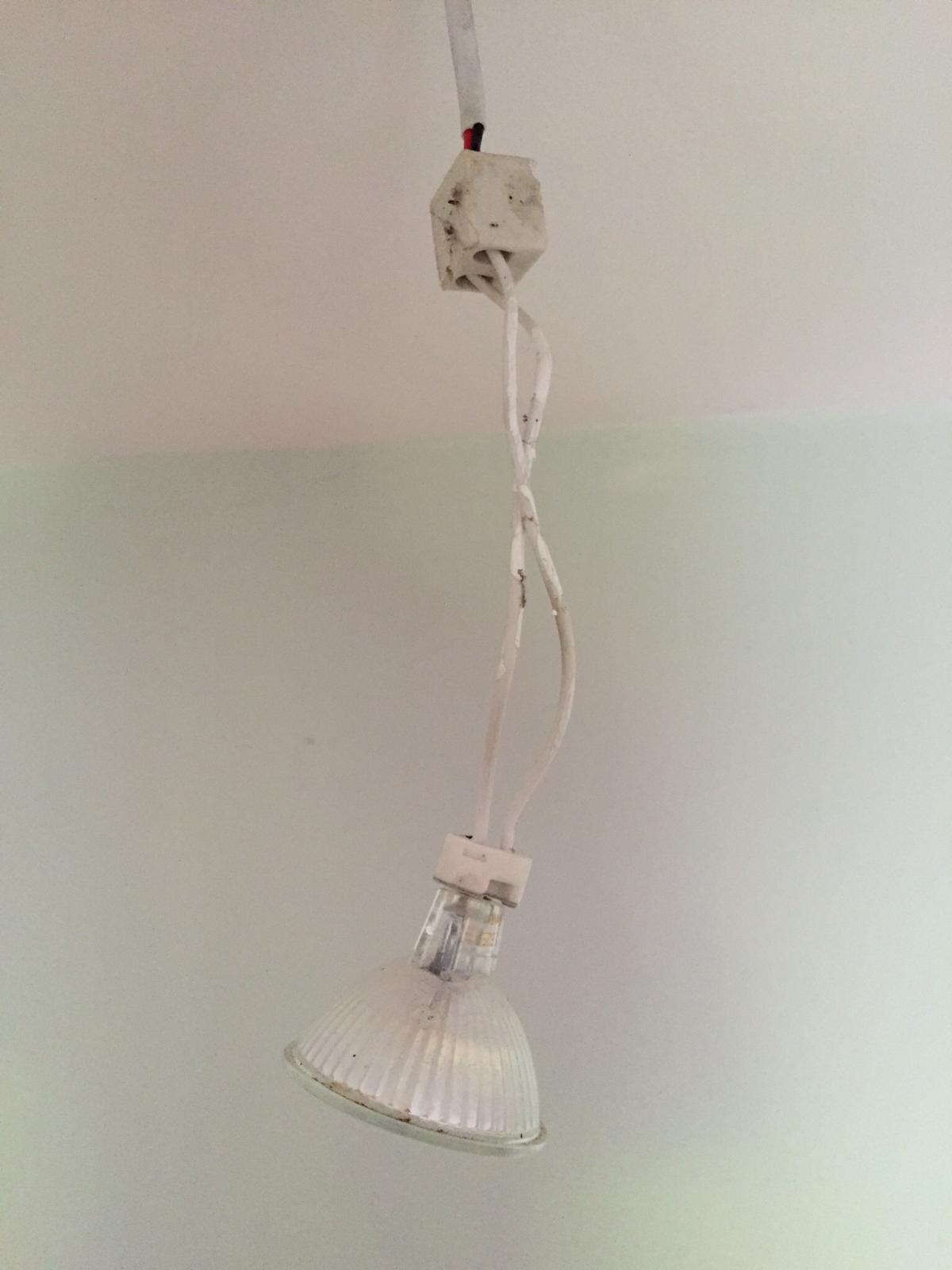

Just an update. My bulbs from LED hut arrived and fitted easily inside the existing housing. The new bulbs were identical in dimensions to the existing ones. Annoyingly I couldn't do one as the electrician, or previous owner had hard wired a bulb to the wires rather than use a GU10 fitting! Had to order a GU10 fitting now. Grrrr
That looks like a mr16 not a gu10. Mr16 will have a transformer in the line down to 12v.
I couldn't pull the bulb out. I was planning on just wiring a GU10 socket into the join block in the photo. I can't see there being a transformer just for 1 bulb?
Not impossible you can gave 50w mr16. There was 7 transformers in my kitchen before I switched to led (1 per bulb). If it is mr16 it just pulls out the ceramic holder. It can take a bit of force if the bulb has been in a while as the spring mechanism indents the prongs. I've had to prise one with a small screw driver before. Obviously make sure its switched off before doing this.
I'm trying to avoid lifting the floor above to see what's at the end of the wires :(. I'll see what's attaché the existing bulb is when I get the GU10 socket and therefor the ladders out again. I don't understand why 1 of 6 is left like this (Borg :) )
Ummmm.... That does look like an MR16 lamp. Be careful! Could be mains or LV. Even if 12v may be A/C not D/C. Will kill a LV LED dead if A/C.

The photo is definitely mr16, I had these in the kitchen and after a few years the bulb holders become useless and need to be replaced. This has been replaced hence the block connector.

Hi. Me again. So I ordered a GU10 fitting form amazon and replaced that odd socket with the GU10 one and it didnt work. The buld did not light at all. So, I may have a dodgy GU10 connection or it could be something to do with the voltage. It seems odd that 1 of 6 is a different conneciton. I  have pulled as much slack as I can on the main cable and cant see if theres a transformer to 12V on it :(. So I guess the easiest thing is to leave it and oerder an LED bulb with the two spikes type connection instead? Any ideas? What a pain in the butt!
The other 5 replacements are all fine by the way.
