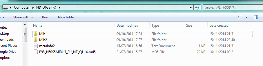

What do you have in the root of the SD card, a single folder or a few folders? If it is a single folder, copy the contents of the folder to the root and then delete the folder. The card can be formatted as FAT32 or ntfs but exfat doesn't work.
I have a single folder and one more file. Card is formatted as NTFS.
That's not right then - it should look like this
Ahhh I'm with you, mine is still in its 'original' folder. I'll have another go later.
I've tried this update on my Columbus and I've got the same message as andy361. The SD card looks to be exactly the same setup as you've shown andyvee and formatted in fat32. Very puzzled!

Managed to sort it, I'd also left the file in the original folder. Now the SD card is in and updating the software
