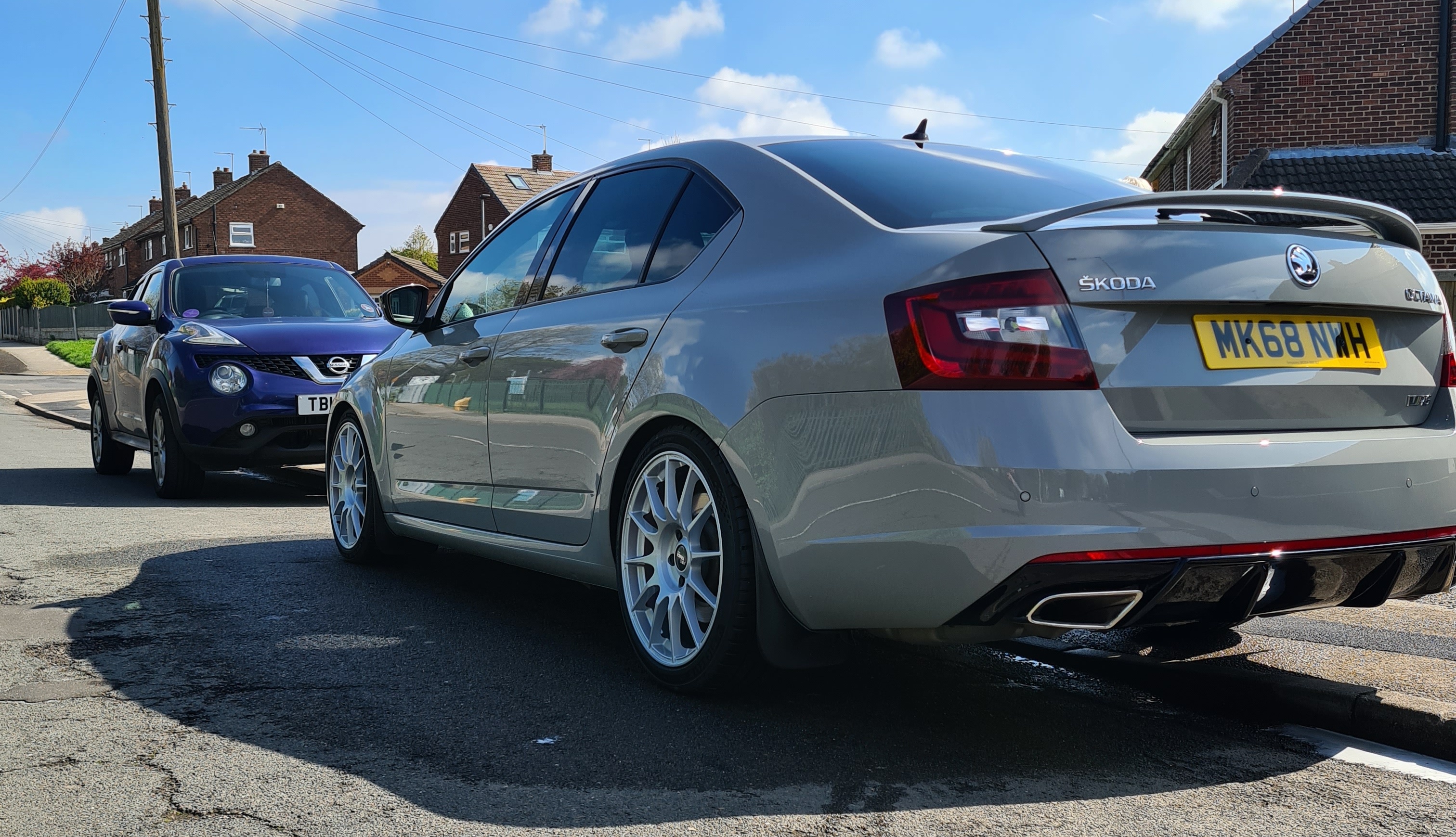

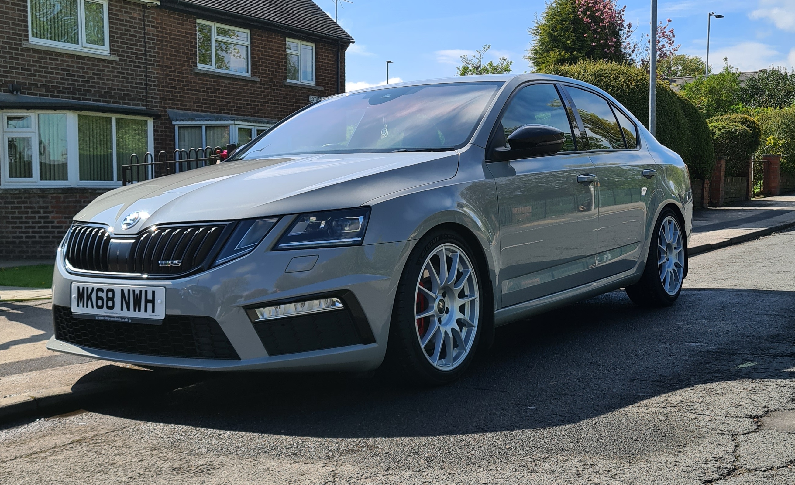

Ok 👍 My point was Dooge's vRS looks slightly high, even though it is lower from the factory. I've attached a couple of photos of my standard vRS on level ground. Admittedly I'm only going off looks from a photo and not actual measurements but there seems to be a difference. Not even sure what the point is I'm trying to prove 😂
Protrack wheels ONE
Yours does look low, but from looking around over the time I've had mine I think most dont look as low as yours. Yours looks like it has springs fitted?
That front arch gap definitely looks standard.

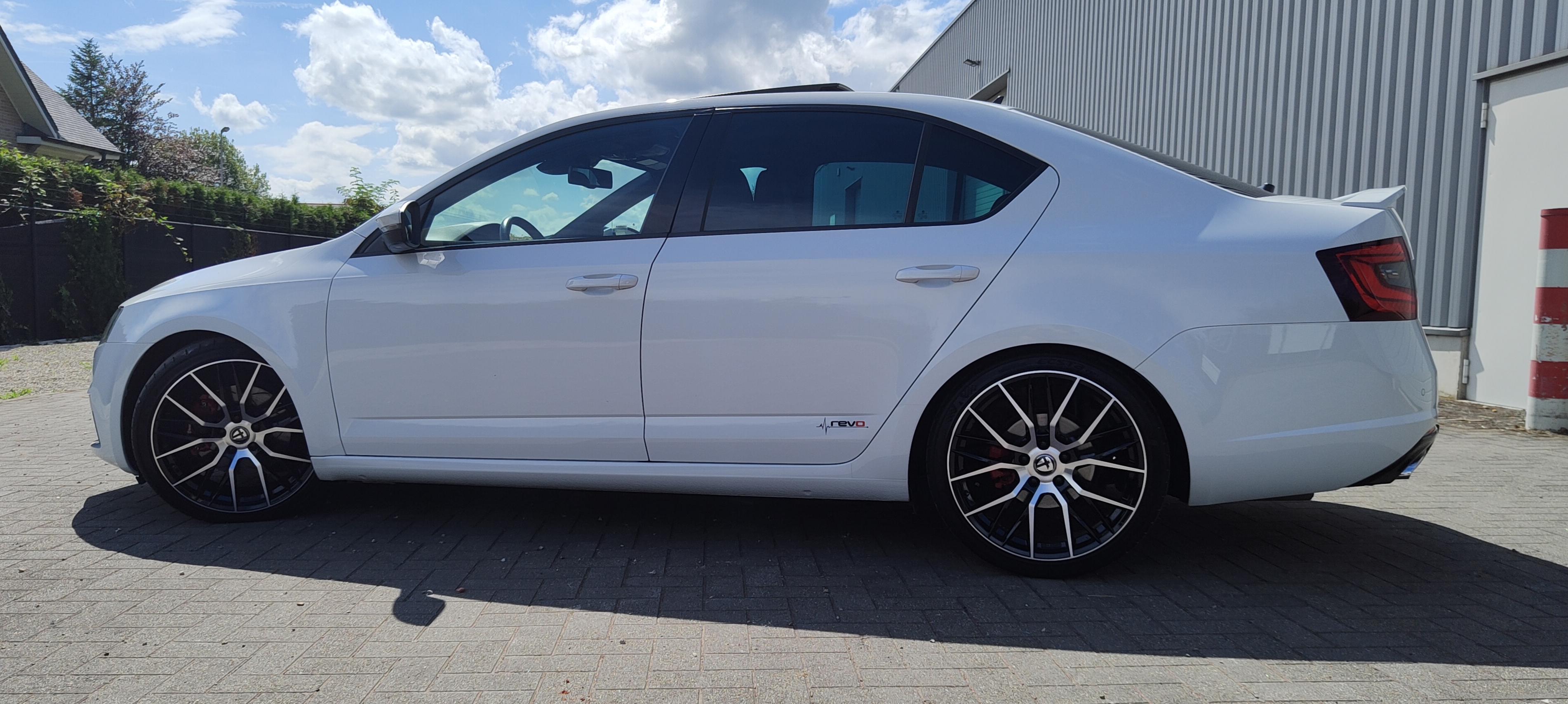

Hi all, yesterday i bought a set of rims from Octavia 3 VRS model of rims something like "Extreme' with parameters 7,5J et51 19 inch with tires 225/35/19.
I attach a photo on the seller car, but my is with stock susspension.
Can you advice me when i use them on my car is it possible to fit with tires 225/40/19 or 235/40/19?

12 hours ago, djnako1234 said:
..yesterday i bought a set of rims from an Octavia MK3 VRS model of rims something like "Extreme" with specification 225/35R19 7.5Jx19 ET51...is it possible to fit with tires 225/40R19 or 235/40R19?
