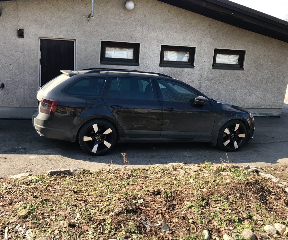

Have to take better pictures of a clean car, but heres one from the side:

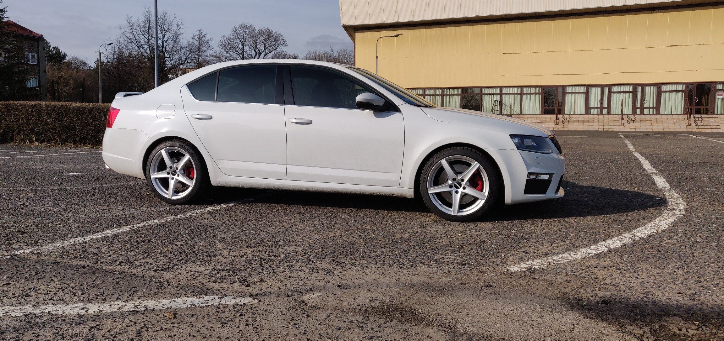

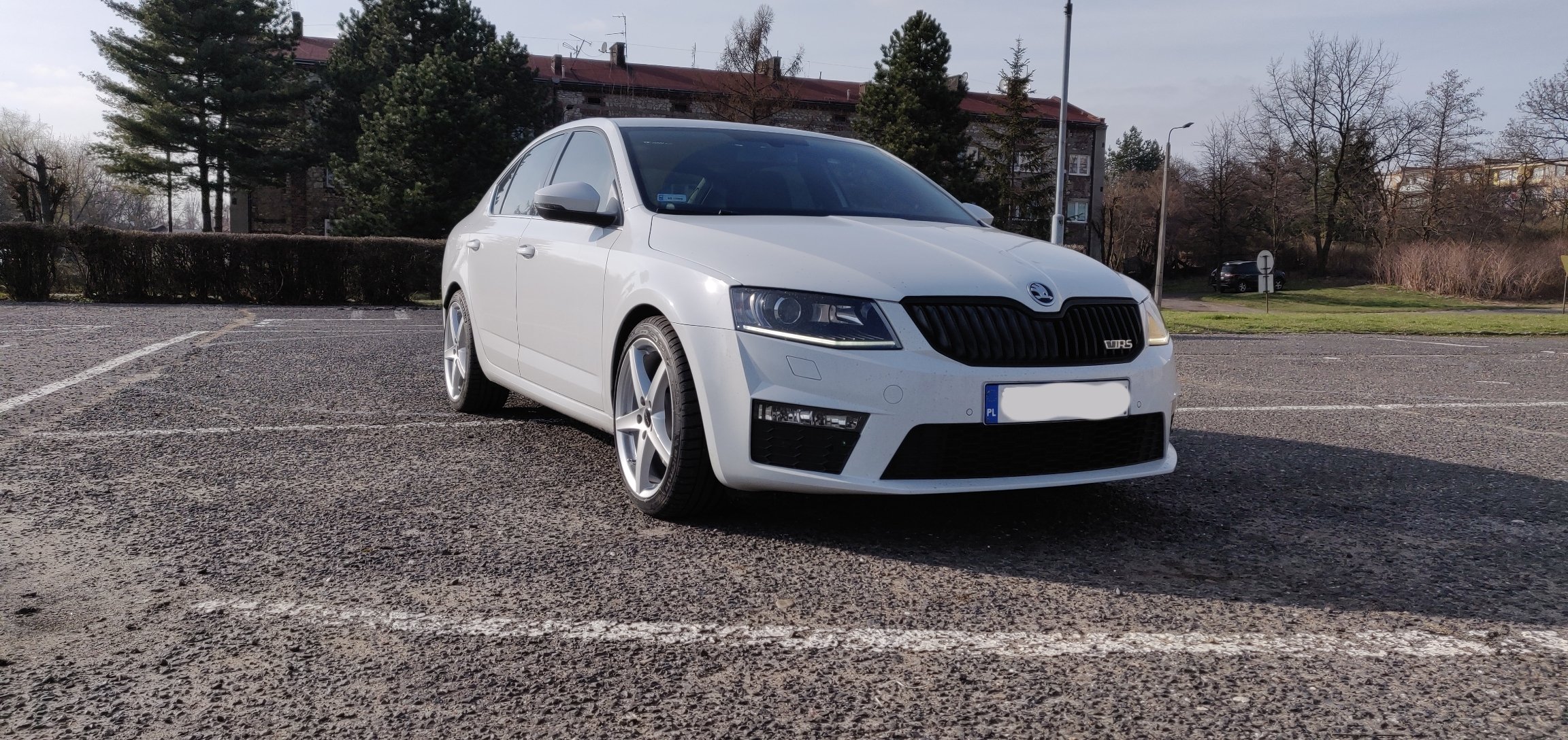

Fitted week ago :)
Ronal R41 18x8 ET35 with PilotSport 4 225/40
Stock shocks with Eibach Pro Kit
IMG_20190329_153256.thumb.jpg.b31c1474e56edae93c6df3ff9d9857e8.jpgIMG_20190329_153417.thumb.jpg.b4d46081666993c1c552a06d1916a66b.jpg
29 minutes ago, Mr0czny said:
Fitted week ago :)
You have indirectly answered my question above since your car shows it is possible to go from standard offset to et35...I assume there are no clearance issues?

yup no clerance issues
but i have my2014 and you have RS245 ... facelift models have wider rear hub than prefacelift
and as far i know ET45 is safe in FL models for 8" width rim
