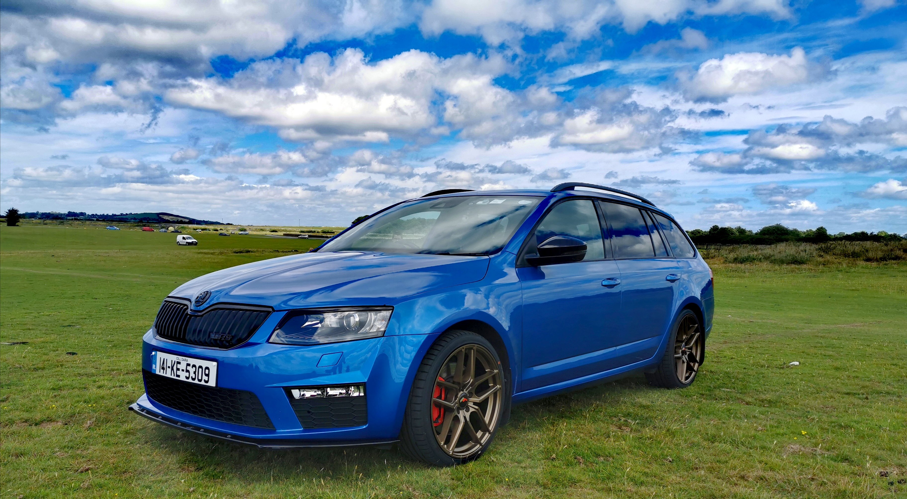

Looking into Ispiri ISR8 in Matte bronze 19"x 8.5j with an ET of 45 to go on a Quartz Metal Combi
Ispiri ISR8 Matt carbon bronze
The regular versions fit (black, silver) according to the configurator but they have an ET of 42, will the extra ET be too muhc?
I run Ispiris 19"x 8.5J with ET37. You'll be just fine.
18 x 8j et45 is considered safe then on a facelift 230?

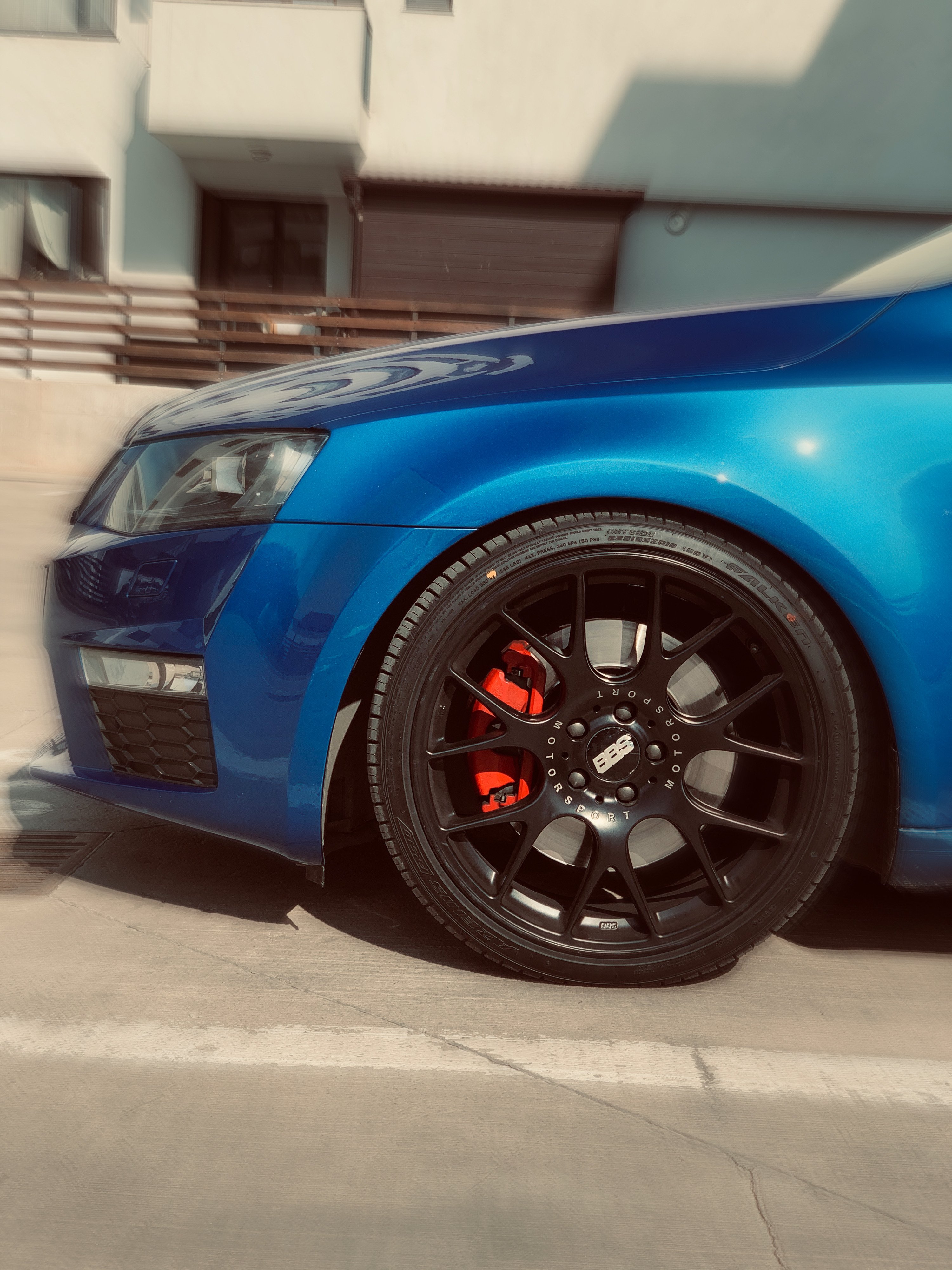

BBS CH-R wheels
19x8.5
ET40
weight - 10.1 kg
tyres Falken Azenis FK510 UHP 225/35/19
BC Racing coilovers (height and damping adjunsment)
the extreme setup that you can put on your skoda (tried and tested) is 19 or 20” with 9J ET33 and tyre 215/35 ;)

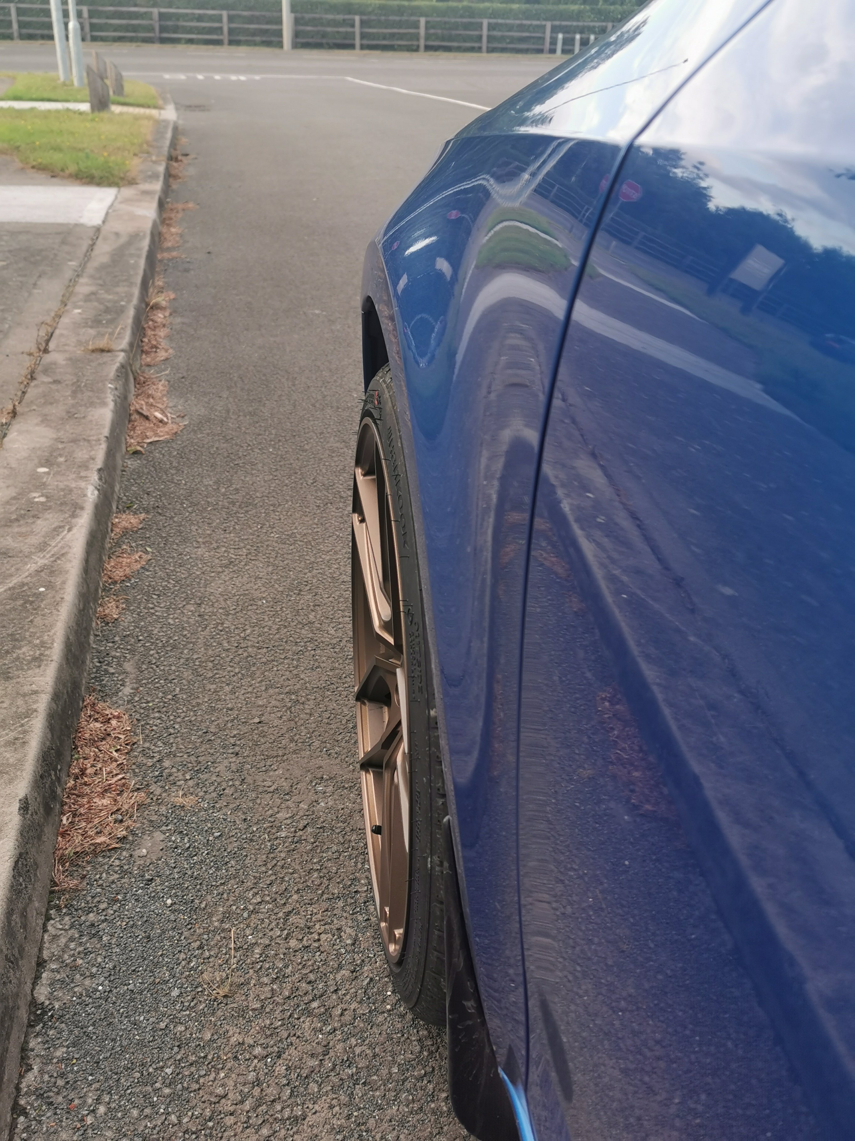

New wheels on my mk3 last week.Japan Racing JR25 8.5 x 19 et40 with 225/35/19 tyres. Fit well, no spacers yet. Might try 12mm spacers on the back. Needs to be lowered at some point too.

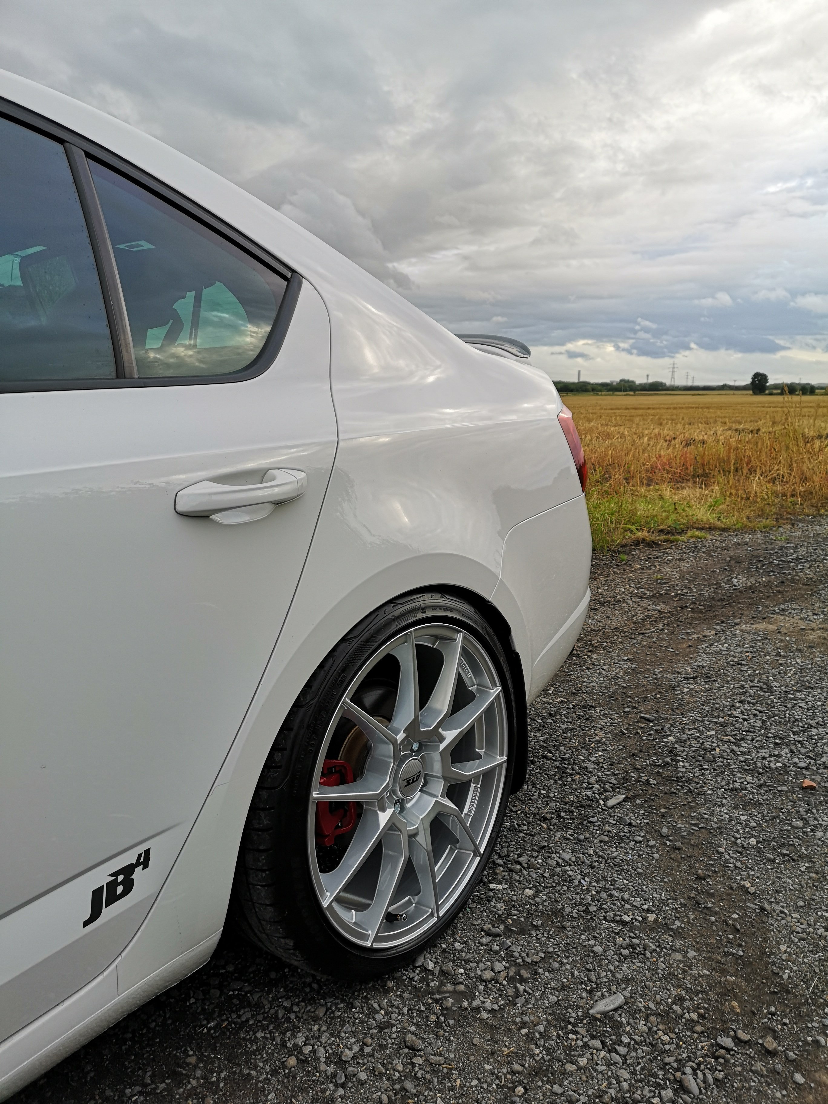

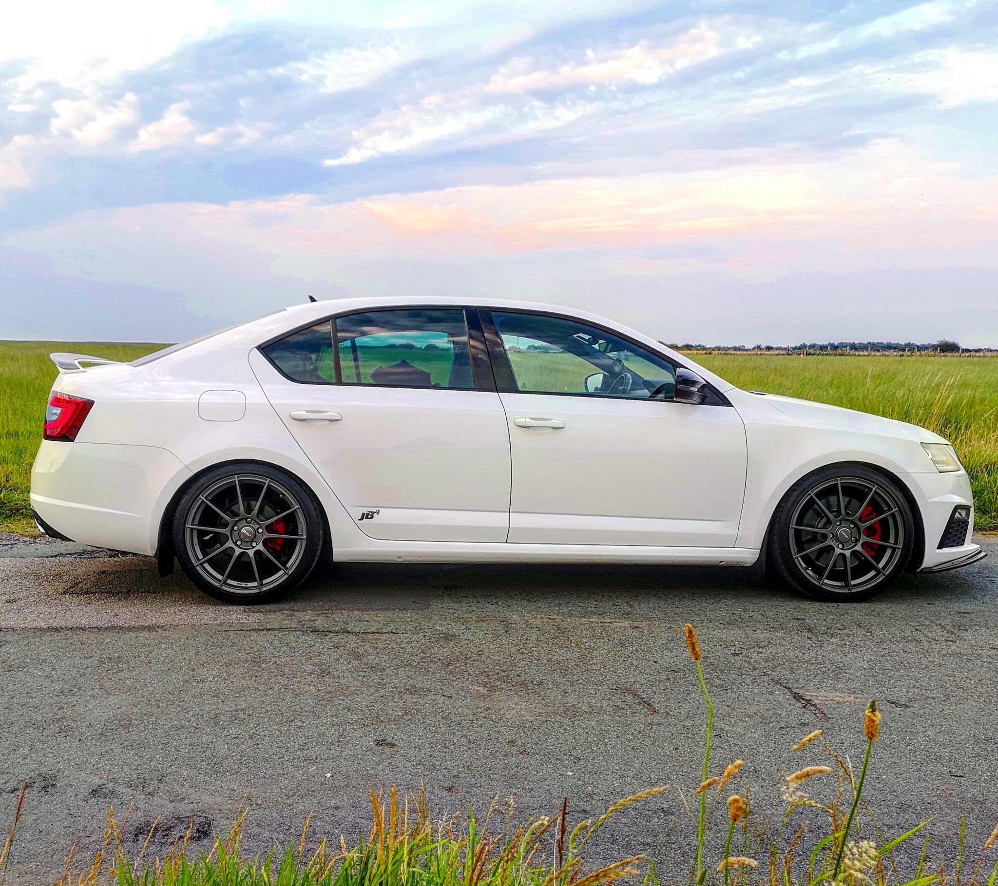

Selling my autecs, got bored of the grey colour. Going for a silver ATS racelight in 19 x 8.5j et 45 (10kg)
My opinion is the same here as well...
Eh?
*edit, just seen the comment on CS. You'd be surprised, black or grey obvs contrast better on a white car, but silver just go with everything and are a nice clean look.

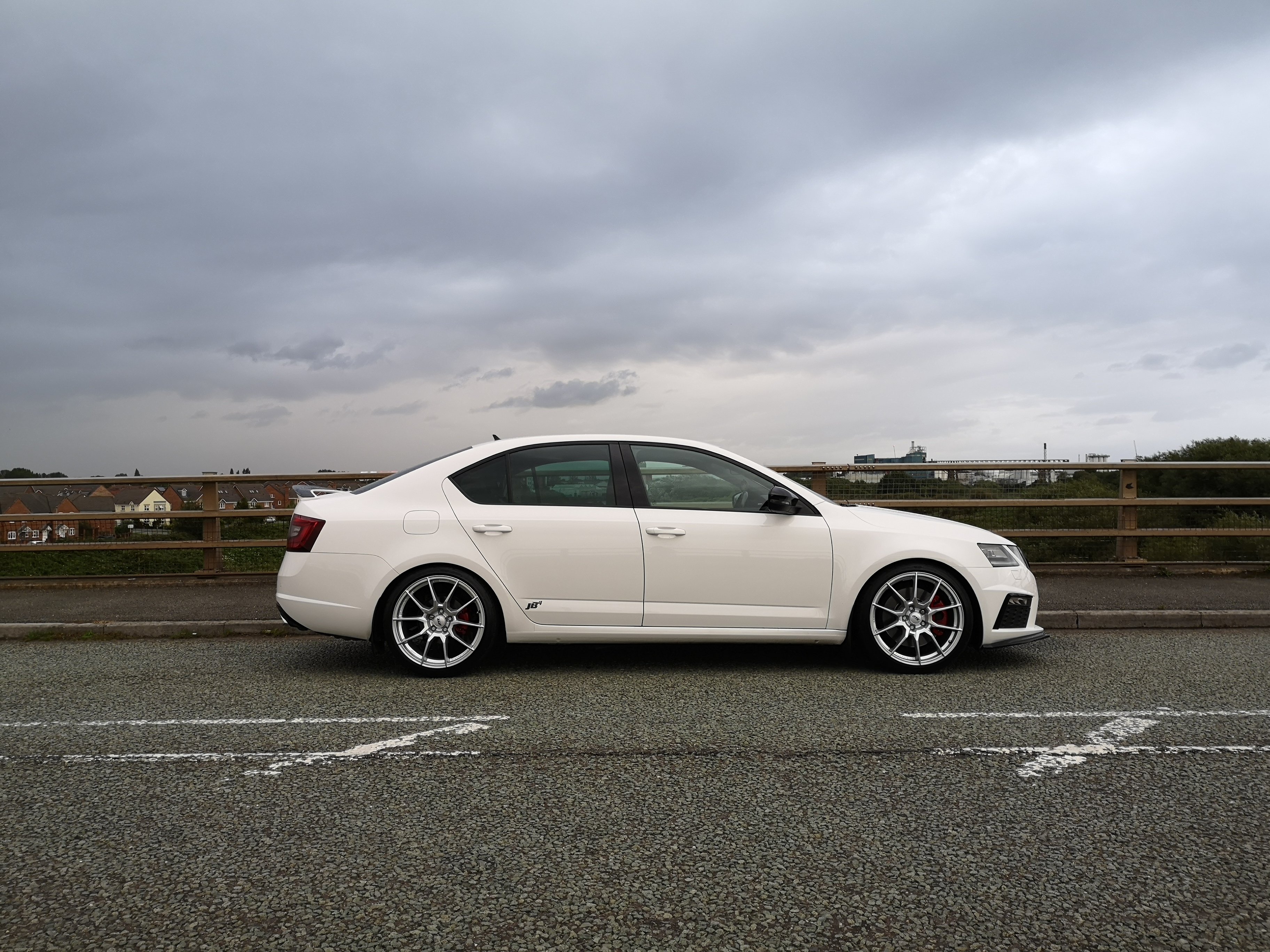

Here are the new wheels. As a few have said, I think  8.5j et 45 is as much as you can go on a facelift, on the rears. 235 35 19 tyres, it's fairly close, even with -1 deg camber but hasn't rubbed as yet so all good.
These look good 👍, fills up the rear arch perfectly!
Honestly?
I think you hit the sweet spot with the Autecs and those aren't as nice.
The Autecs are lovely.  One of the only wheels that I'd consider changing to tbh.  Those and OZ ultraleggeras.
Wheels always gonna be subjective. Autecs were nice but everyone's got painted alloys now.. If they were silver and a lower offset then I'd have another set. I'll probs change again in 2021 lolz

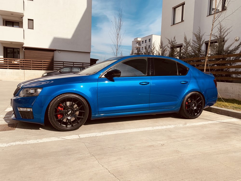

Hey everyone,
I got my Octavia recently, it's a Pre-FL 2015 model with 19" OEM Xtreme wheels. I've decided I want to go down to 18" wheels, specifically these BBS reps from CM Wheels when they're in stock. I'll also order some Eibach Pro-Kit springs and changes the shocks to Bilstein B12's too and fit this all at once.
https://cmwheels.com/product/18-bbs-ch-style-wheels-gun-metal-vw-audi-mercedes-5x112/
I have multiple reasons for wanting to downsize, being the poor road quality in my area, cheaper tires with more selection available that can fit 18x8 (225/40/18) and I think the 19's look comically big on the car and are also easy to kerb.
Judging by what I've seen in this thread, there should be no issue running these 18x8 ET42 wheels on a lowered car, correct me if I'm wrong :)
