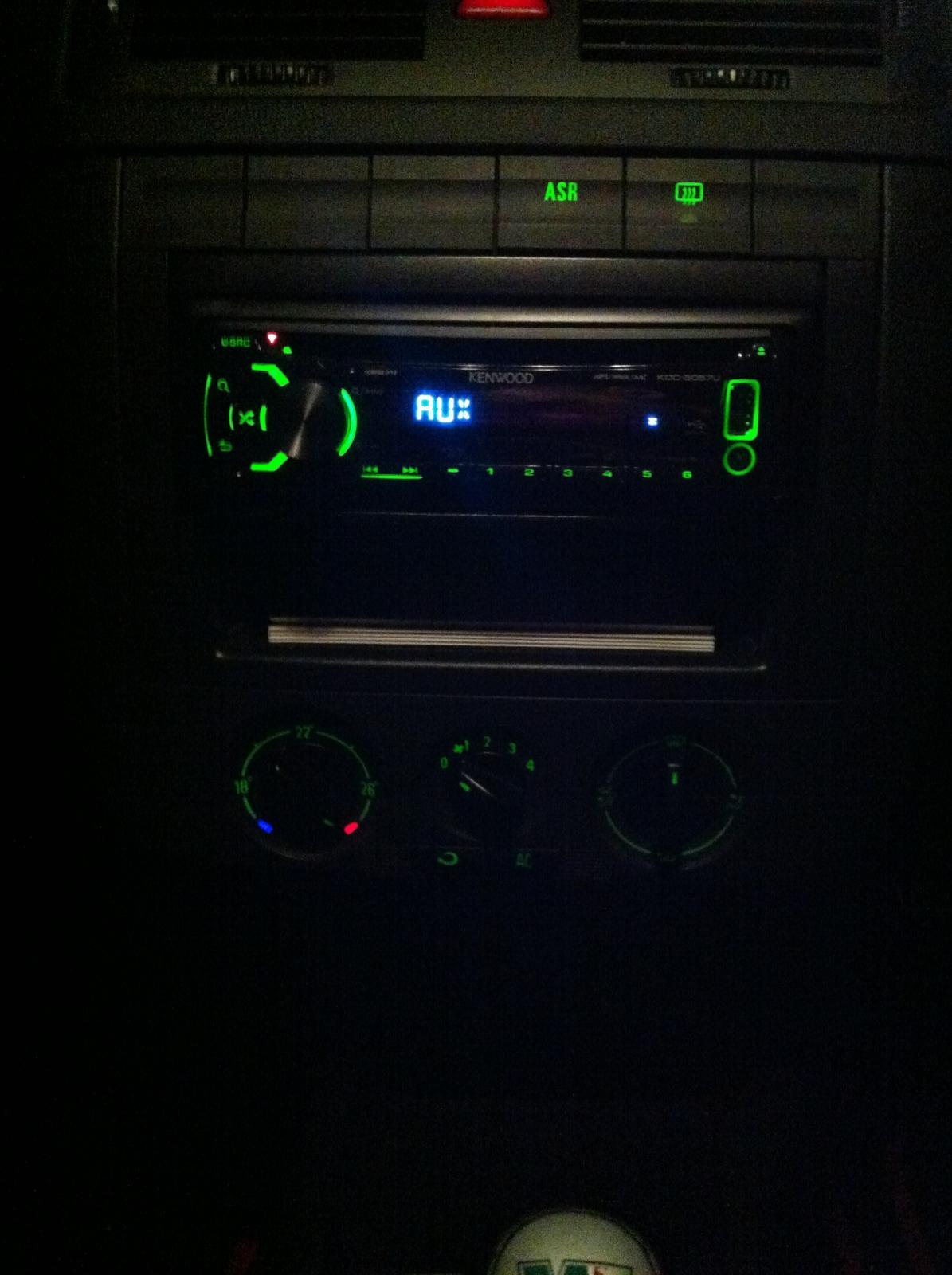

I have an aftermarket head unit in my Fabia VRS Mk1 KENWOOD KDC-3057UG CD, MP3, AUX, USB Interface. Had it for about a year now and is really good, I got this 1 mainly because the green goes with the interior lights(ish) I think it looks half decent compared to the likes of JVC, ALDI specials etc :D  Would probably cost around £100-£130 fitted?
