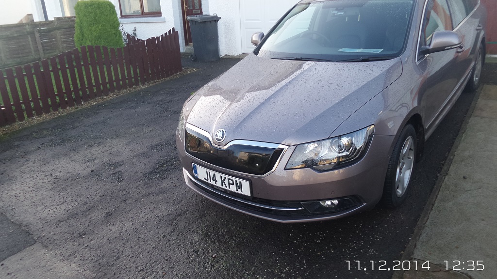

Go and buy the two grill covers from Super Skoda which limit the cold air into the radiators, this cuts warm up time down by at least half, but still allows the fan to bring in cold air from else where to cool the radiator.
I have the cold weather grille fitted and definately made a difference on mine regarding warming up and economy. Purchased from superskoda.
