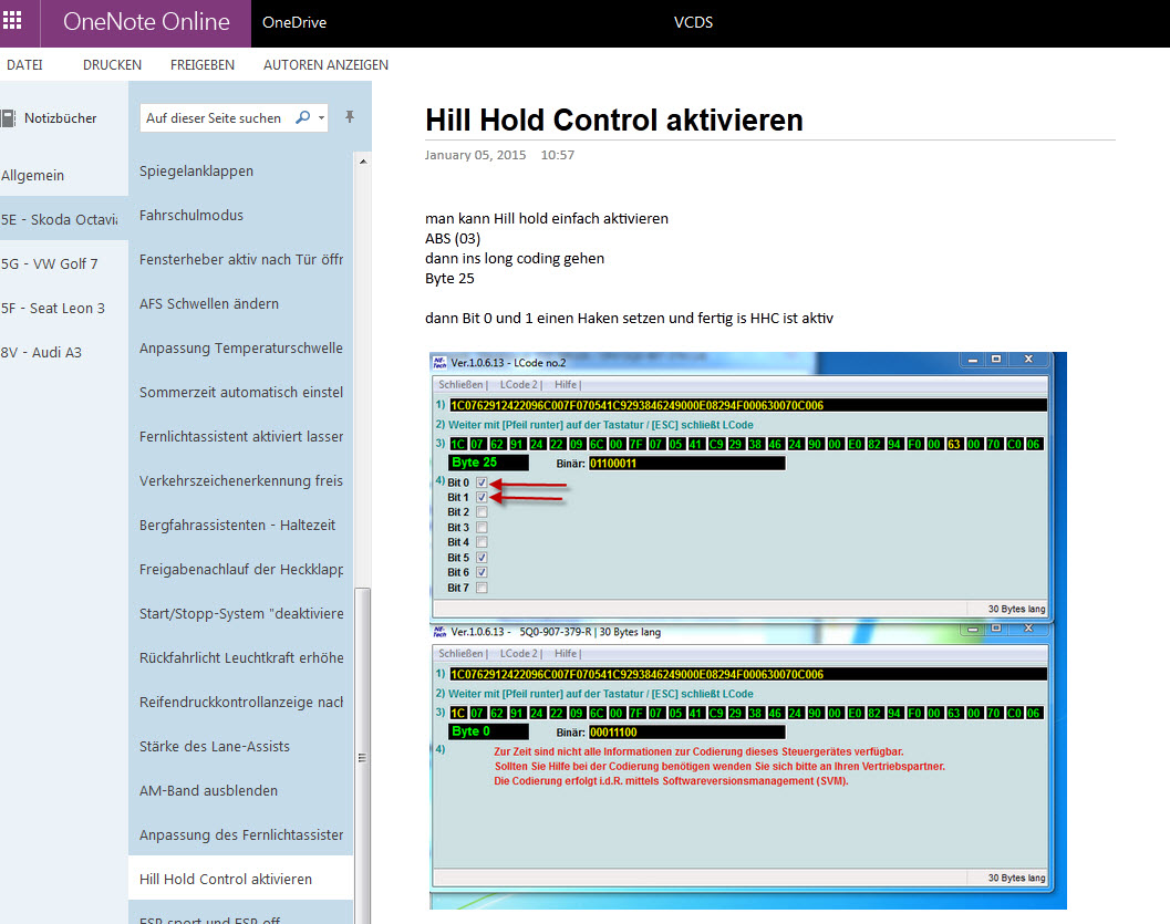

other example: you can change 2 bits to get HHC (hill hold) activ in my car, the APK was existing before also with inactiv lonngcoding. So the Lcode is improtant to be correct to set the HHC adaptation. I guess it is the same with XDS frist the Lcode must set than XDS will be adapt by APK.

Today I managed to change my XDS setting from 'Standard' to 'Strong'. :)
Mine is a MY14 Elegance with '5Q0 907 379 R' ABS controller.
The adaptation channel is called 'No display' in current version of VCDS.
I made some tests on wet road with full throttle while cornering and I think I can feel the difference. :)
