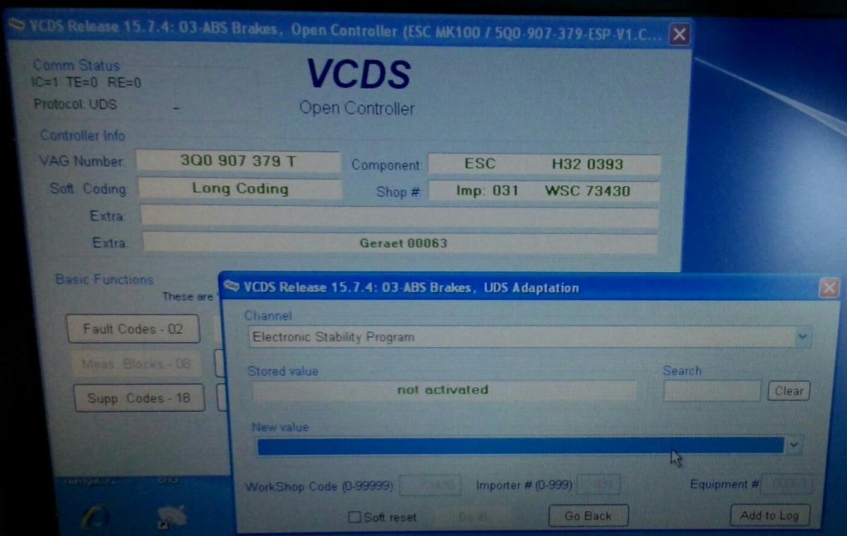

Today I managed to change my XDS setting from 'Standard' to 'Strong'. :)
Mine is a MY14 Elegance with '5Q0 907 379 R' ABS controller.
The adaptation channel is called 'No display' in current version of VCDS.
I made some tests on wet road with full throttle while cornering and I think I can feel the difference. :)
I did not notice any change with normal driving though.
More testing will follow...

On the german forum they suggest enabling bit 1 and/or bit 2 on Byte 23.
Unfortunately this made no difference in my case. I tried all 3 combinations.
My inner wheel is still spinning, like on my video.
Probably this is not the complete coding or my ABS controller doesn't support this feature.
No luck here. :(

I noticed yesterday looking in 03 ABS Brake that ESP is 'not activated'?
Odd. I thought that ESP was always on? Maybe it means something else.
Maybe @andyvee might know?
Edited by Higgy 69
Channel name isn't 100% correct.
VAS shows the same channel as 'ESP only in higher speed range' or something like that.
I have read about it somewhere.
Mine is not activated as well, but I definitely have ESP.
