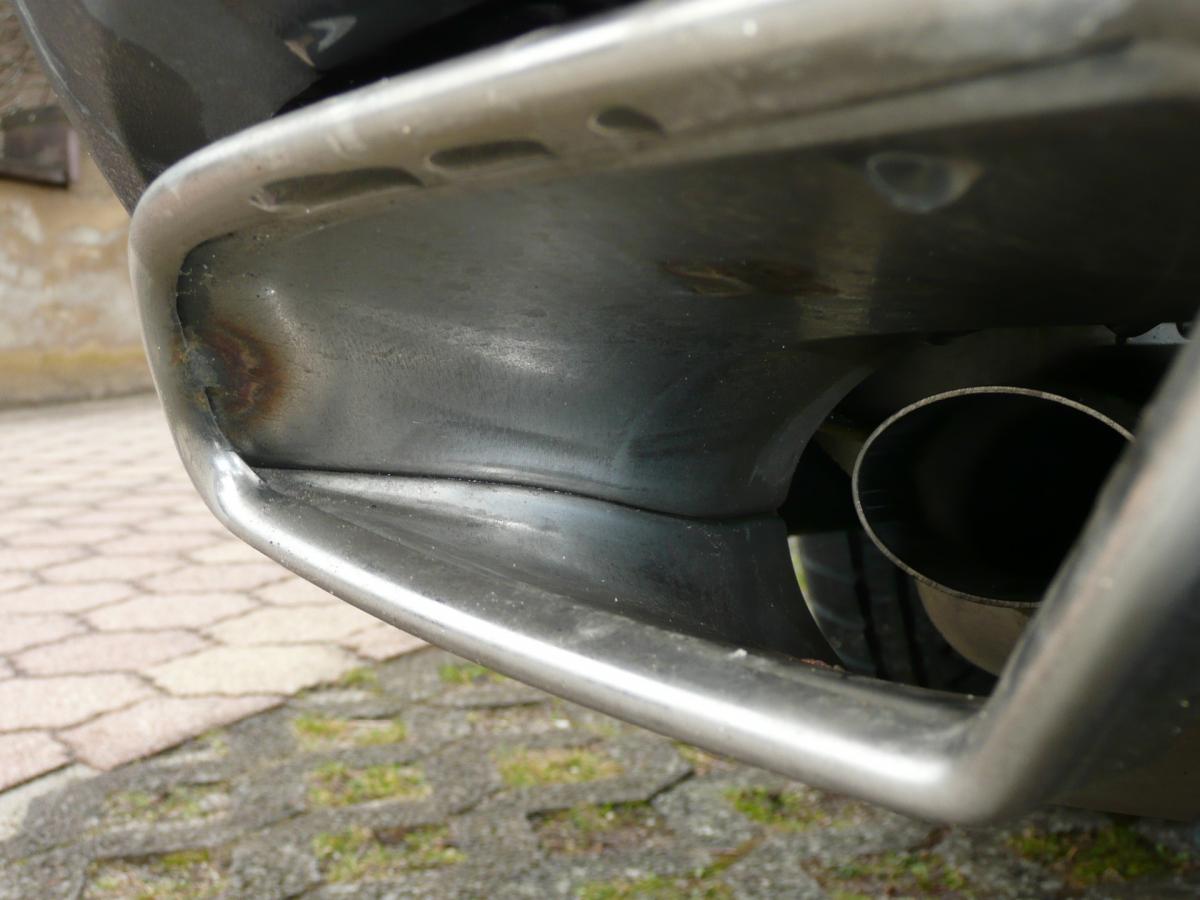

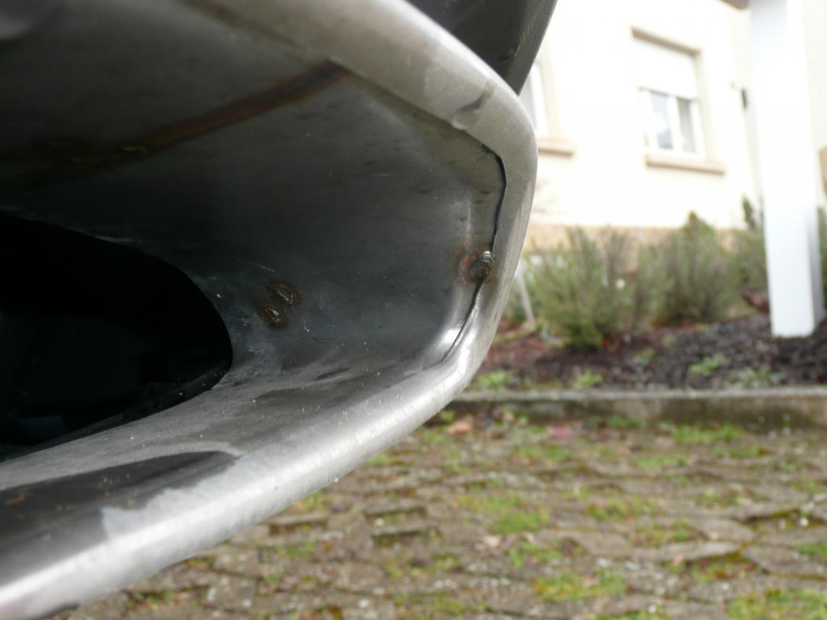

Been out in the dark with a torch. Sorry I misinterpreted the post. I was thinking the weld was in the actual trim that completed the full circumference. Mine has spot welds on both sides of both stainless trims, where the black "funnel" bit connects. The welds are painted black to blend in.
Please excuse the state of the car...it's a disgrace

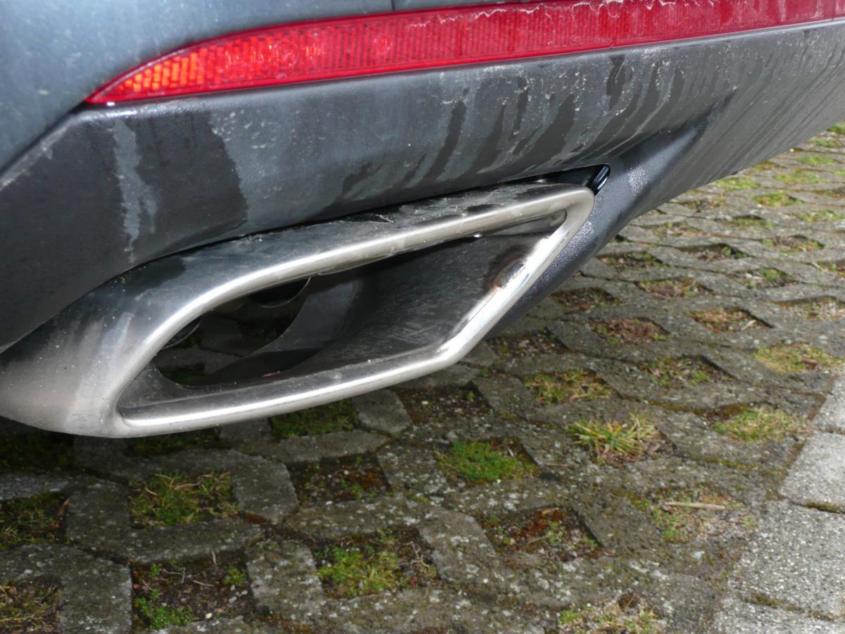

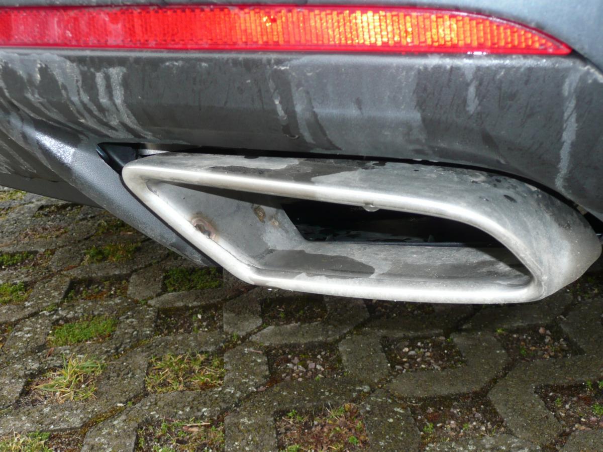

This is how mine looks. Not too impressed, but as I said before I'm thinking about making them black anyways so doesn't matter.. (a bit like this or at least on the inside like this)
The exhaust trim will rust slightly, I don't think I've ever had a car with stainless tailpipes that hasn't. It's kind of like stainless cutlery getting rust spots on in the dishwasher.
Just polished some rust spots of my "tailpipes" this afternoon after washing it, takes 30 seconds so no big deal.
The brown staining on a new pipe is most likely just a but of heat discolouration from the welding process(stainless steel exhausts normally go a yellow to brown colour when exposed to heat) . Autosol will remove it. Mine are now a year old and haven't got any corrosion yet but they could do with a bloody good clean. They shouldn't suffer too badly as unlike a normal stainless exhaust they don't get hot but if you let muck sit on them for months at a time you will get corrosion although it should sand/buff out unlike chrome plated parts
I have just washed my vrs and noticed the same thing. They are not actually attached to the exhaust system but merely trims. They appear to be mild steel wrapped in stainless steel. The rust spots are where the mild and stainless are welded together. Probably be an idea to dab a bit of silver hamerite on the affected areas to preserve the look of the trims. Other paints are available.
