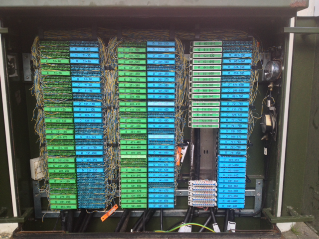

Just joined last year as a copper jointer. Not done any since Yarnfield in December. All I do is tie cable stuff between DSLAMS and cabs.
Love the job so far but hate the admin bull****. Close to launching the iphone on a few occasions. lol
Had an interesting one today though, non standard. Had to find some old Krones. D side is the far right last ten then the other five to the left then E side is the fifteen. Had a job to find the covers with the numbers on aswell
I've watched you on here since you applied and got the job,most of the jointing on new work machines are used that makes it a lot easier ,but the job(bull) didn't get to me till after about 30yrs.so enjoy summers on the way.

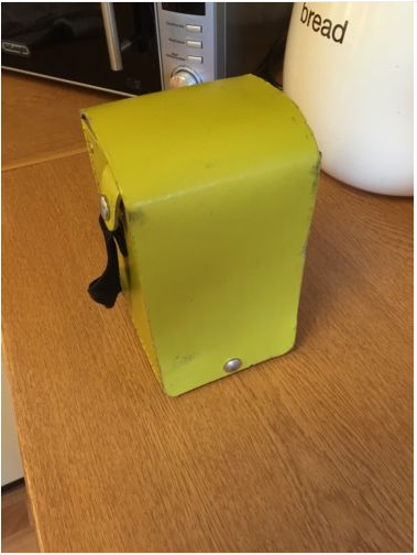

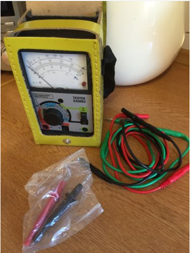

Just bought this off ebay, as good as new £60 inc delivery :D
Nice one!
Pleased?
Nice one!
Pleased?
I'll let you know in three to five working days, Wayne :D

Thought I recognised it, as the old BT meter on general issue to BT blokes. The original one was a metal cased brick, but the one in the photo is plastic cased( as far as I can see ,and from the one I was last issued with). Possibly 20k/volt sensitivity. Great meter for telecomms work - you might find it better than the one BT provide, which from my information is a Fluke digital, but with no line reversal ( ballistic test) facility ( waits for Soot1e to educate Lee on this). ( Lee- in old country exchanges, there was a line test facility. You plugged  SA9083 into test set, and plugged test leads into number to be tested. Various tests could be performed, including looking for voltage on line. If all was well then a ballistic test could be performed. This involved the line reversal switch on SA9083, which would show capacitance of  each leg of line to subscriber instrument, looking for the bell capacitor on the phone, and could indicate if line was broken "dis one leg" or not)
Wavey- Avo's were a great meter on the bench ,but for telecoms work in the field, I'd prefer an OLDE SA9083, metal cased brick. Steve- for work tracing feeds on car/truck, i'd suggest making a 12/24v switch able diode probe.
