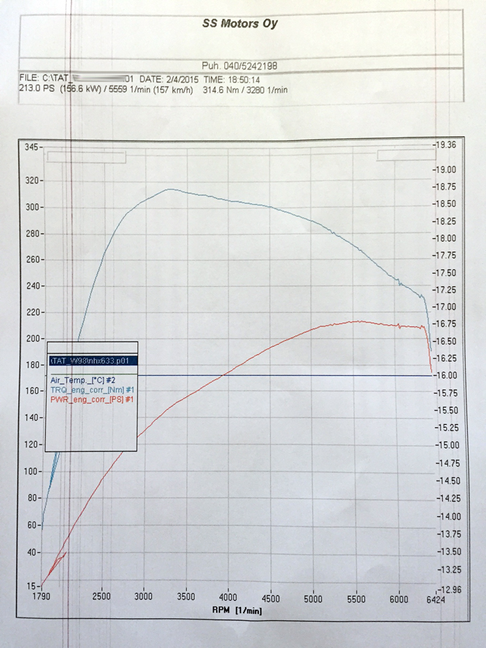

Back to this topic. I had the car on rolling road today and I must say that the results were very impressive. So impressive I nearly want to call BS on it myself.
This rolling road had very good feedback on accuracy on many forums and clubs. They build rally cars. And this is why I decided to go there.
So this is a CAVE unit with the current Revo stage 1. No other mods to the car. Using V-power.
213 hp
315 Nm
Pretty aggressive as well as you can see from the attached sheet. We did 2 consistent runs, second one 3hp lower on results of course, due to heat.
Unfortunately I don't have a sheet for the stock car to compare if it was on the powerful side already.

Which Spark Plugs do you run with, and have you changed them when you had the REVO Remap done.
What were the plugs like you took out, all 4 in good condition?
NGK 7's went in when it was mapped. You can see my plugs on this threads 2nd page. They were OK.
I didn't want to put excessive load on the gearbox/clutch and APR seemed to do that by pulling 340nm of torque (these are marketing figures of course).
Revo in perf mode 1 should be giving around 200bhp and 270nm which to me seems good in terms of durability.
That's significantly higher than quoted figures. Either an optimistic dyno or REVO are just claiming ****! Although it usually happens the other way round  :D
That's why I was glad I decided to go for before and after runs on the same dyno, under the same conditions. No matter the absolute values, you can see exactly how much you got in return for every buck you paid compared to what you had as stock. Nice graph anyway.

Revo actually claims max 218 hp and 292 Nm in stage 1. Depending on performance mode, gas etc.
I had a play on the performance settings since mapping it though.
