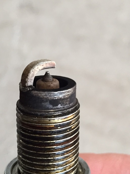

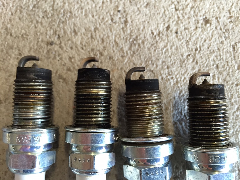

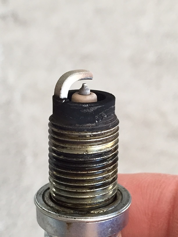

The stock plugs had done approx 6K miles and came out looking like attached. I don't know which number is which, but 2 of them seem to have been running hotter (3&4 I assume). How do these look to you?

Laars, plugs look good, no oil burning evidence present there. The No4 looks like there is some detonation in that cylinder, see those darker colour dots?
In theory they should all look exactly the same, the best is No1 and No3 are perfect, No2 looks a bit hot. Over all they look much better than most of the plugs I've seen so far from a MK2 vRS.

Great, thanks Jabozuma for the comments. I might have the plugs in the wrong order in that pic, as it was garage doing the job, I don't know which plug came from which cylinder.
I suspect the good ones should be in the middle, pots 2&3 and the "bad ones" pots 1&4.
