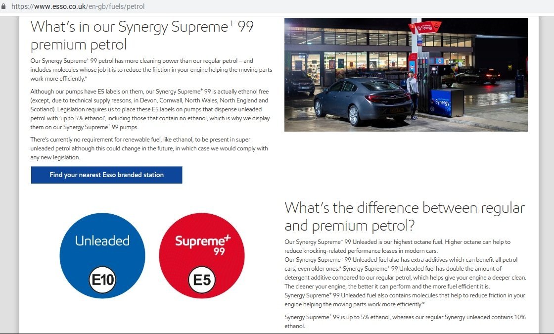

Here are the test results that Tesco had done which were really more about emissions.
It would be good to see similar test results done with 95 ron unleaded E10  and 97 or 99 ron Super Unleaded E5.
Since this thread from 2015 Esso Super Unleaded is now 99 ron minimum.

I do recall those results and recall the battle I had with my expenses claims department telling them the Fabia VRS Twincharge should have 98+ octane and that was the economical choice for that car.  Many of the other fuel card holders were putting in 97,98,99  octane in their cars which were designed to run OK on 95 octane.  Back in these days 5% Ethanol applied to 95 and the higher octanes.
Been reading lots of stuff on the E10 and putting in alternate high octane, low ethanol, especially the Esso 99 which has no ethanol, is looking more attractive or for a second choice Tesco Momentum 99 as always.  Not sure the Clio 900cc, 90 hp is going to be that fussy but worth a feel test.
There are areas of the UK where the ESSO Synergy + 99 will not have Ethanol.
That might be the areas where Greenergy are not the supplier to those filling stations.
So Central England, some of Southern England and parts of Wales is not such a large area regardless of how many vehicles or Esso Filling stations.
Edited by roottoot
