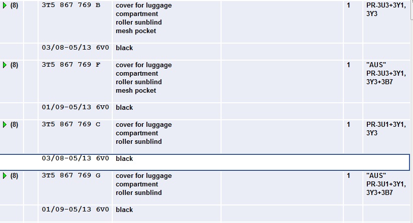

There are two parcel shelf's available with the sunblind incorporated, one with a mesh pocket underneath and one without (I got the one without):
I'm assuming the 'AUS' version is specific for Australia?? :think:
Edited by MarkTB
The F/G say 'AUS' in the PR Code column, i don't know what that means, other than maybe specific for Australia maybe?? :notme:
