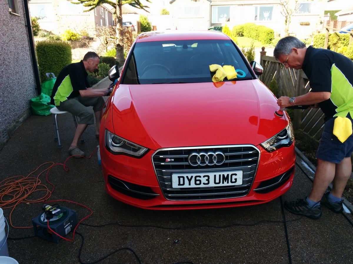

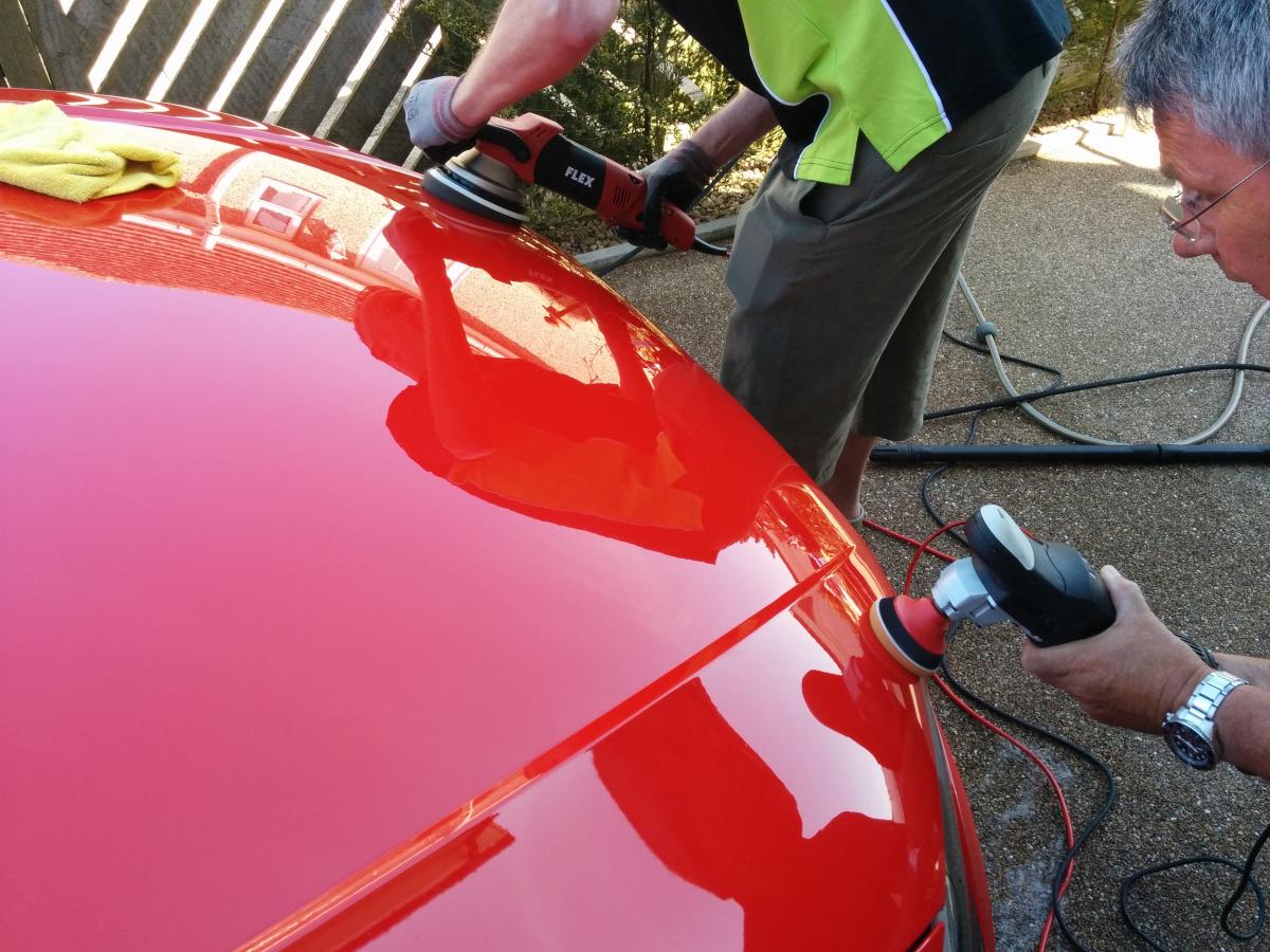

Working on the sanded spots
Alan and Chris hard at work

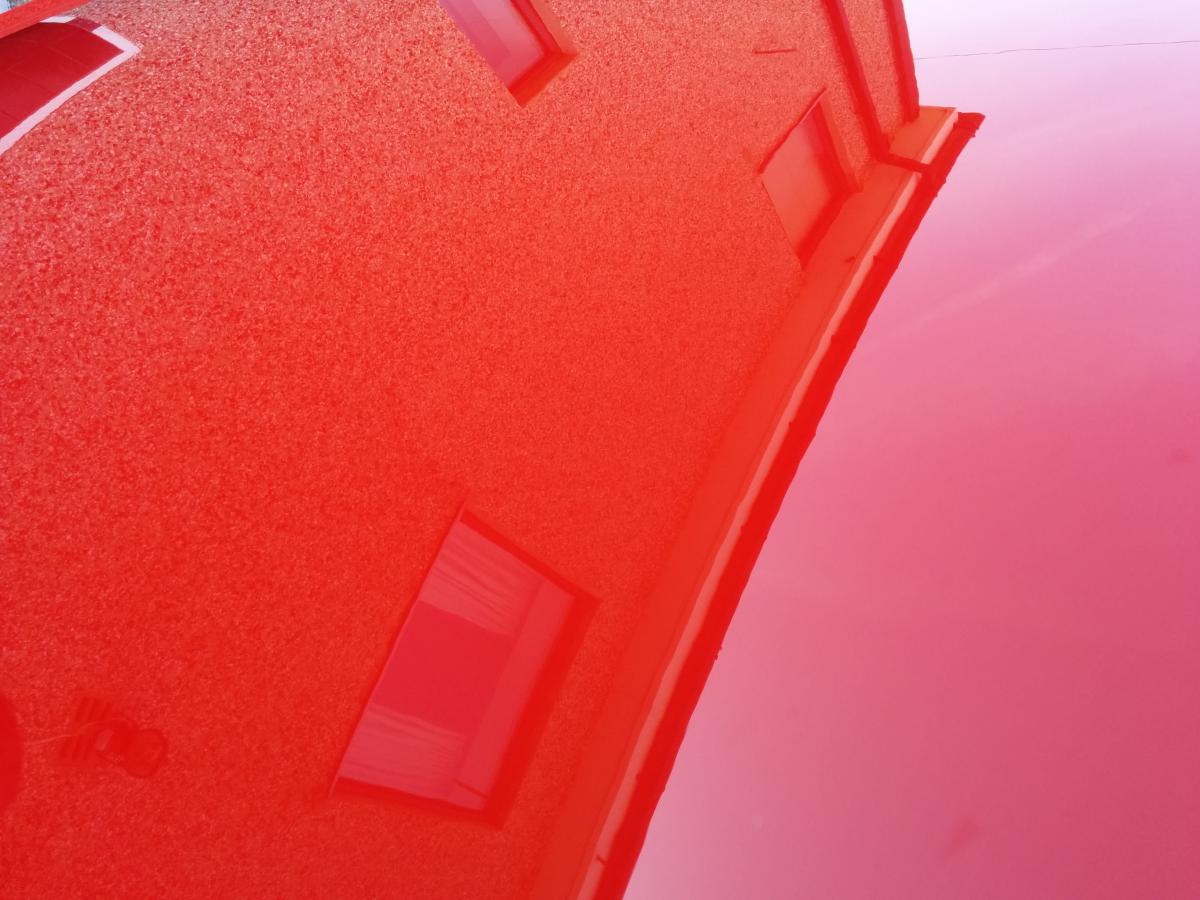

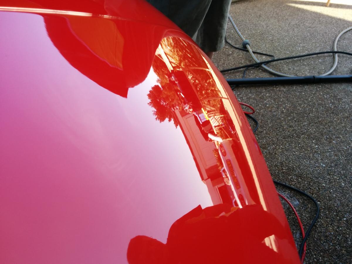

Some reflection porn
post-103429-0-46598100-1429803741_thumb.jpgpost-103429-0-46675900-1429803738_thumb.jpg
