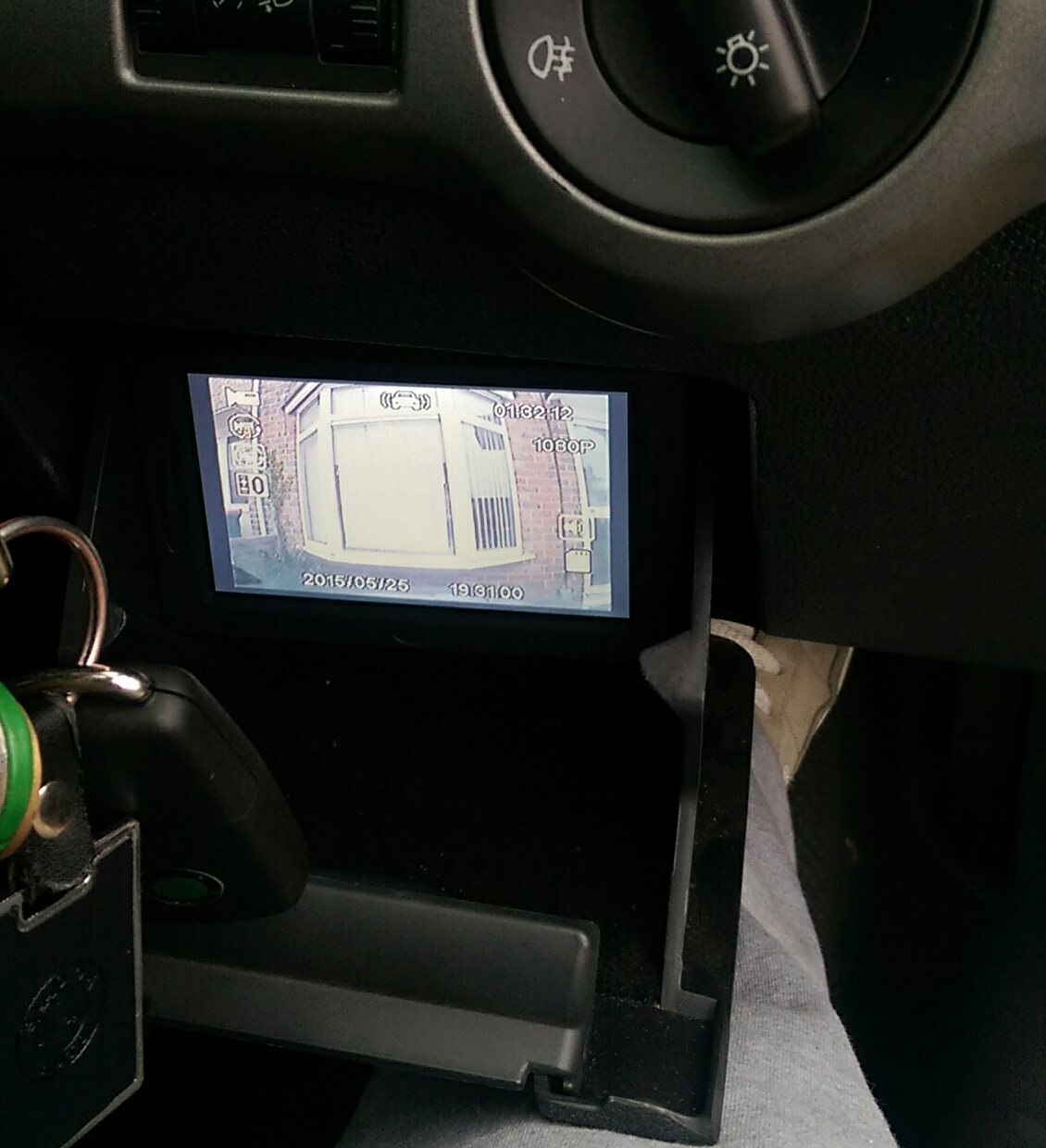

To anyone struggling with no display and setup I got this:
http://www.ebay.co.uk/itm/261856470938?_trksid=p2057872.m2749.l2649&ssPageName=STRK%3AMEBIDX%3AIT
Does the job perfectly, fitted it in the small drop down door think below steering wheel.
Also accepts dual inputs so if you had a rear one too its ideal.
Thats just the sort of thing i was after,ive ordered one & i will wire a male cigarette lighter end onto the wiring on the unit then i can just plug it into the cigarette lighter when i want to set up the cameras etc.  :thumbup:

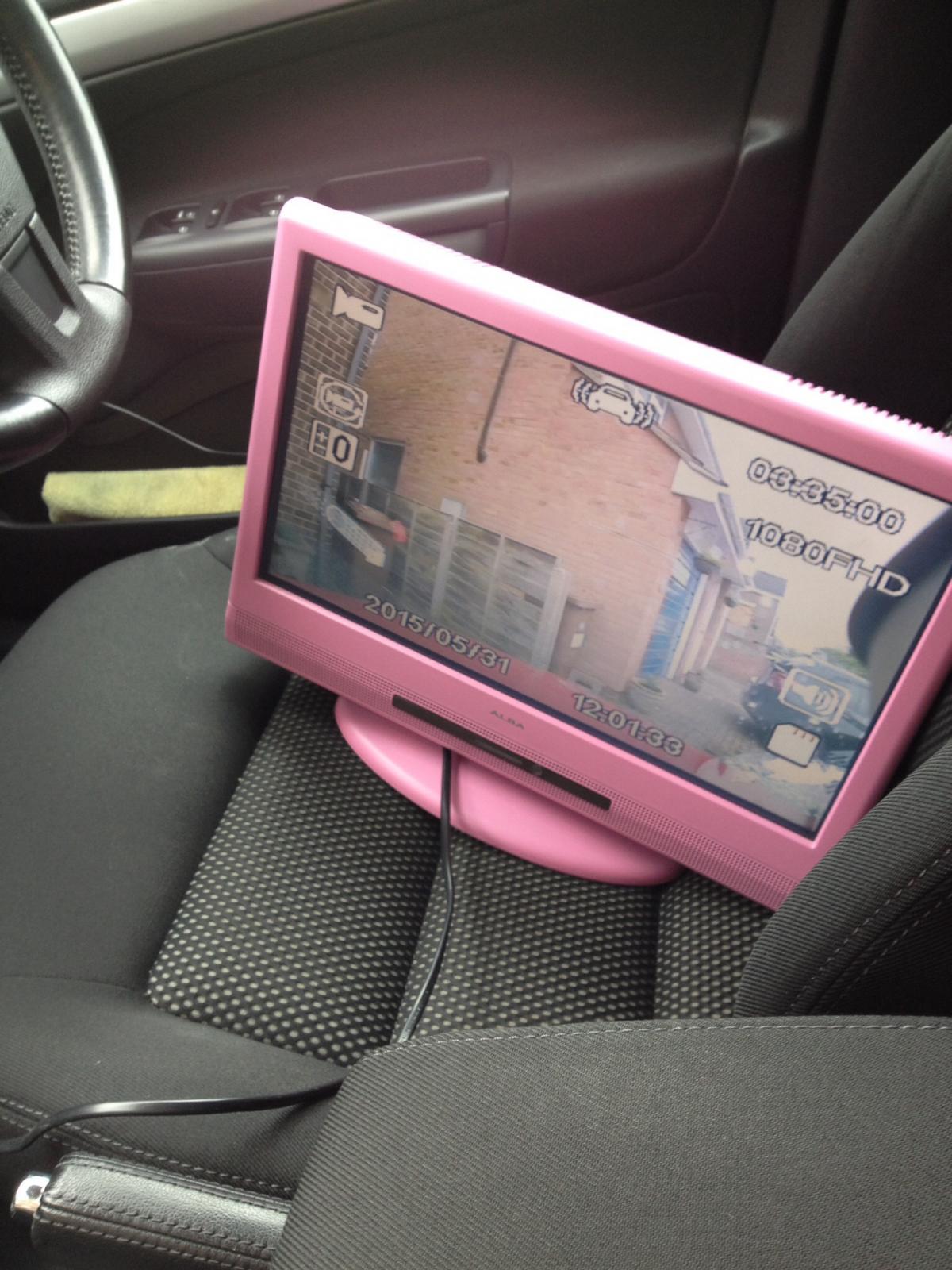

So mine has now got here, quick question if I may,
How do you guys view the camera settings to set it up the first time as I have no display method in the car? Thanks
I linked to a screen earlier for a tenner.
Just seen that, re read the thread, have a small portable TV which I can plug it into to set it up via a scart adapter, will try that first.

Found a low tech solution to setting it up!
