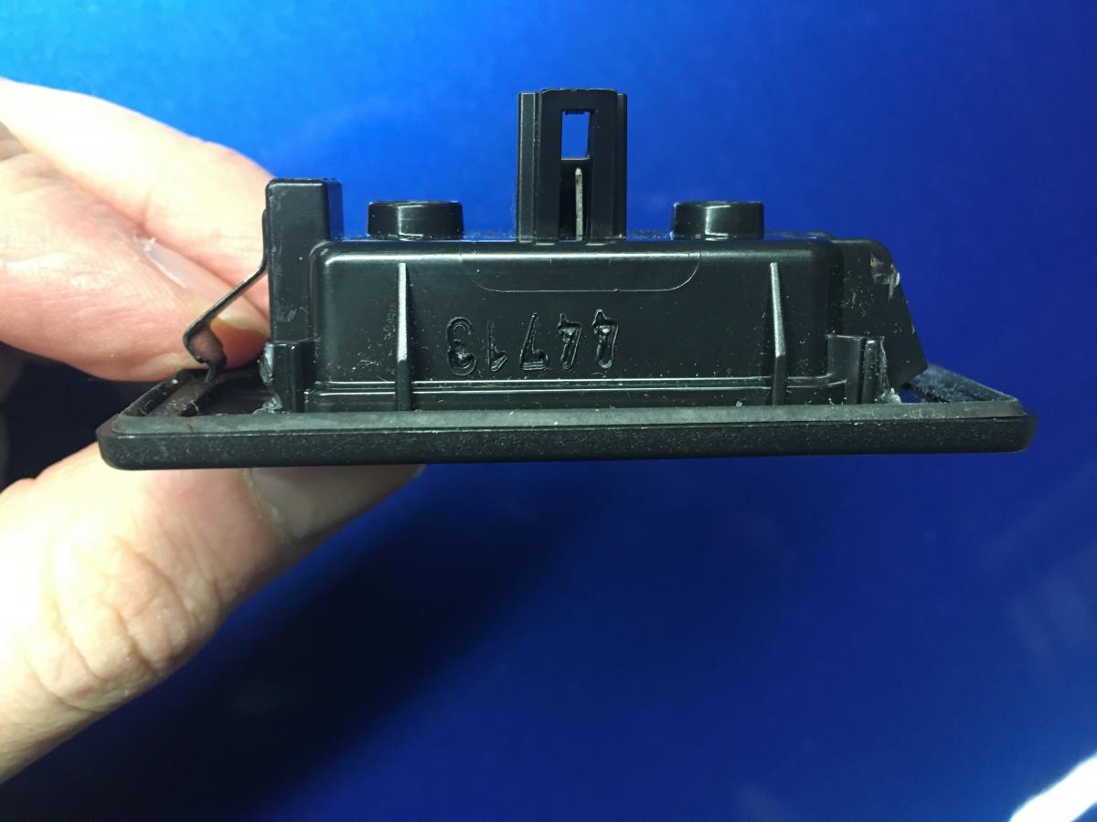

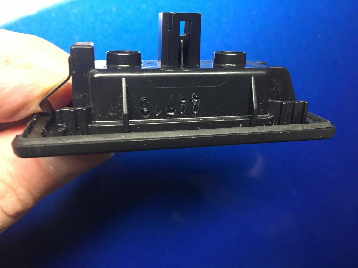

When trying to fit them there are little tabs that stop them from fitting into the hole (you can see the little nic in the left tab where it was stopping it from fitting) The fitting will fit if placed in the opposite way to the original fitting but this then results in the light being directed away from the number plate.
In my opinion they had to be fitted the same way as the original fittings this meant the light was directed onto the number plate. To do this though the tabs had to be removed, i just used some side cutters.
