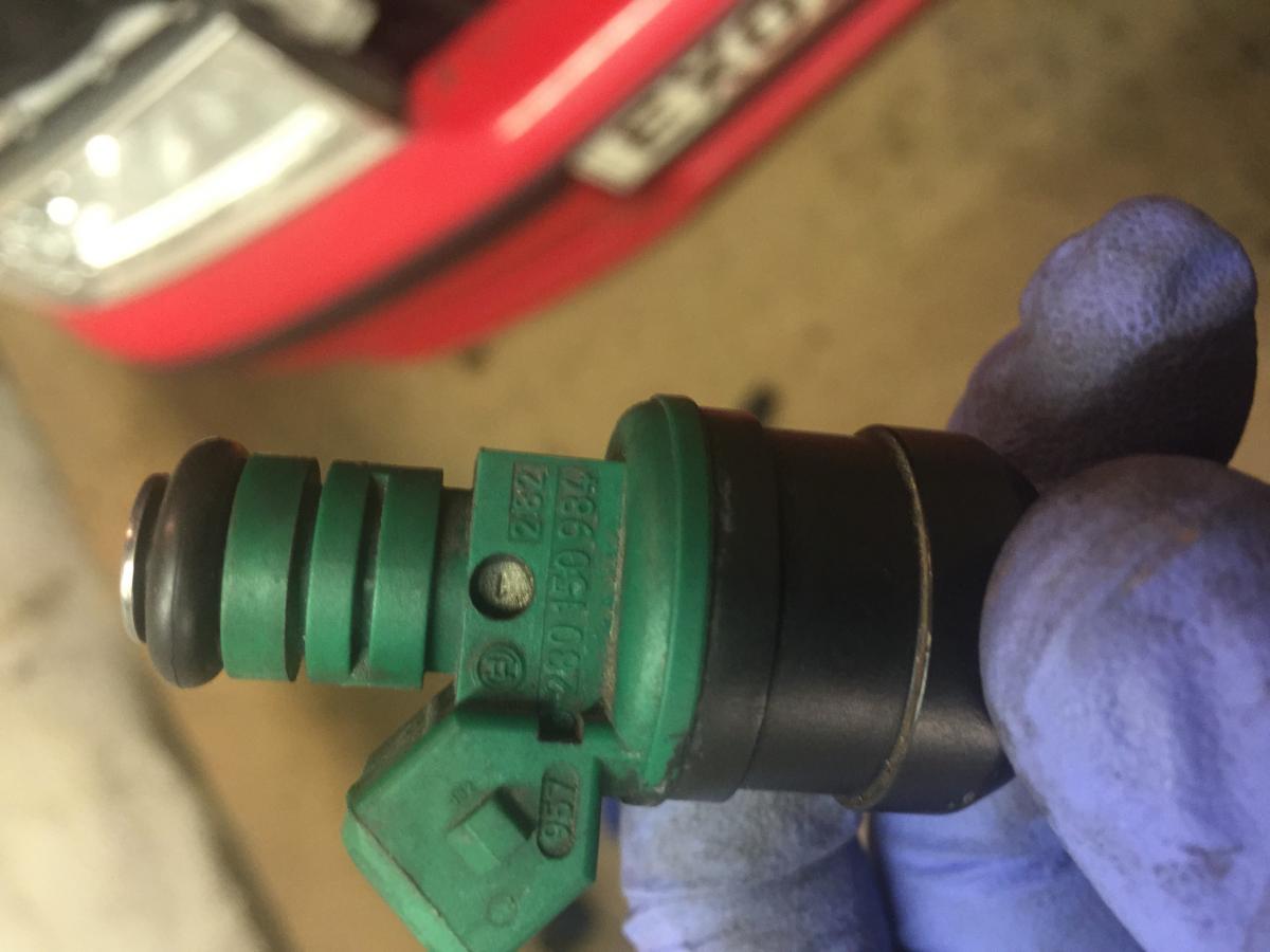

Below is the injector have been told that these are not standard by previous owner the fuel rail was raised by using two nuts each side causing a surge in revs so i looked online and got some 6mm spacers this solved the surge (air getting in i think )
Injector
Has the engine been mapped to use those Audi RS2 345cc injectors? They are bigger than standard vRS but smaller than BAM injectors. I'd be tempted to stick some standard injectors back in to at least eliminate that issue. Is the fuel pressure regulator standard?
