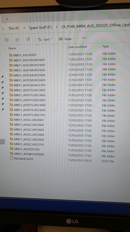

Ok I have never had a unit that had a SD card with it . I recognise what you mean.20250616_195647[1].jpg I went from an RNS 510 DVD drive to a 2019 Tiguan with a 2.5 Amundsen in it and used any old SD card As I understood the VW SD card had protected files etc and you did as you say and even if you formatted that card it didnt remove the protected files. Even now with an MIB3 you must put the files in the ROOT of the Stick and not a folder This as you see is the contents of the folder in the top line and is what goes on the USB C Stick. I have found that you can put it onto a stick that already has stuff on it. Eg I use a 128gb USB C stick with about 1300 music tracks on it. I just copy the files to it and it finds them and installs the map. Have been doing that for years. Just delete them afterwards. Pic is latest AUS map and installed fine last week over 2 short trips

Yea - I see what you mean. I've got no experience of MIB3 units only the MIB2 ones. MIB2 Amundsens must have the original sd card in them at all times while the MIB2 Columbus is a completely different method. Any third party sd card can be used to upgrade the map. The map is then stored in the onboard memory of the actual unit and therefore the sd card can be removed or deployed for another use. As you say MIB3 might be completely different and only the contents need to be copied to the sd card. The original poster did say his unit was a MIB2 though. As long as the file structure is kept to the same layout as his original sd card then he shouldn't have a problem but unfortunately he didn't do a backup.
