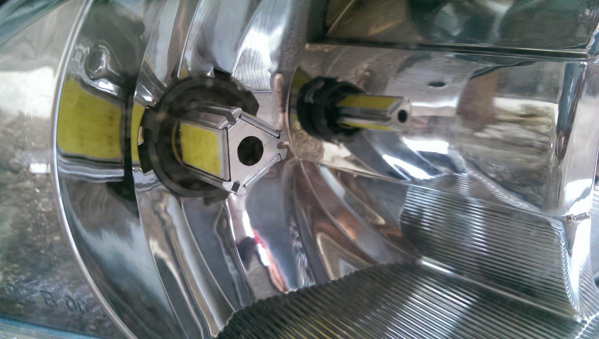

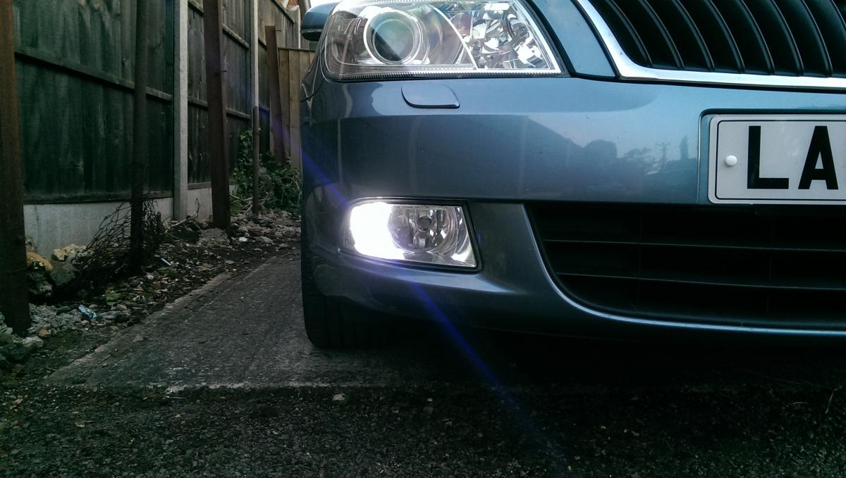

To give you an idea what mine look like I just snapped a couple of pictures although they are quite flattering. It's not as uniform as this in person, I'll try and get a more truthful picture at some stage. Either resistors or VCP coding is required to remove the light out warning.
Now that looks quite good....   As I'll be in the car I won't see how uniform (or not) they are.
