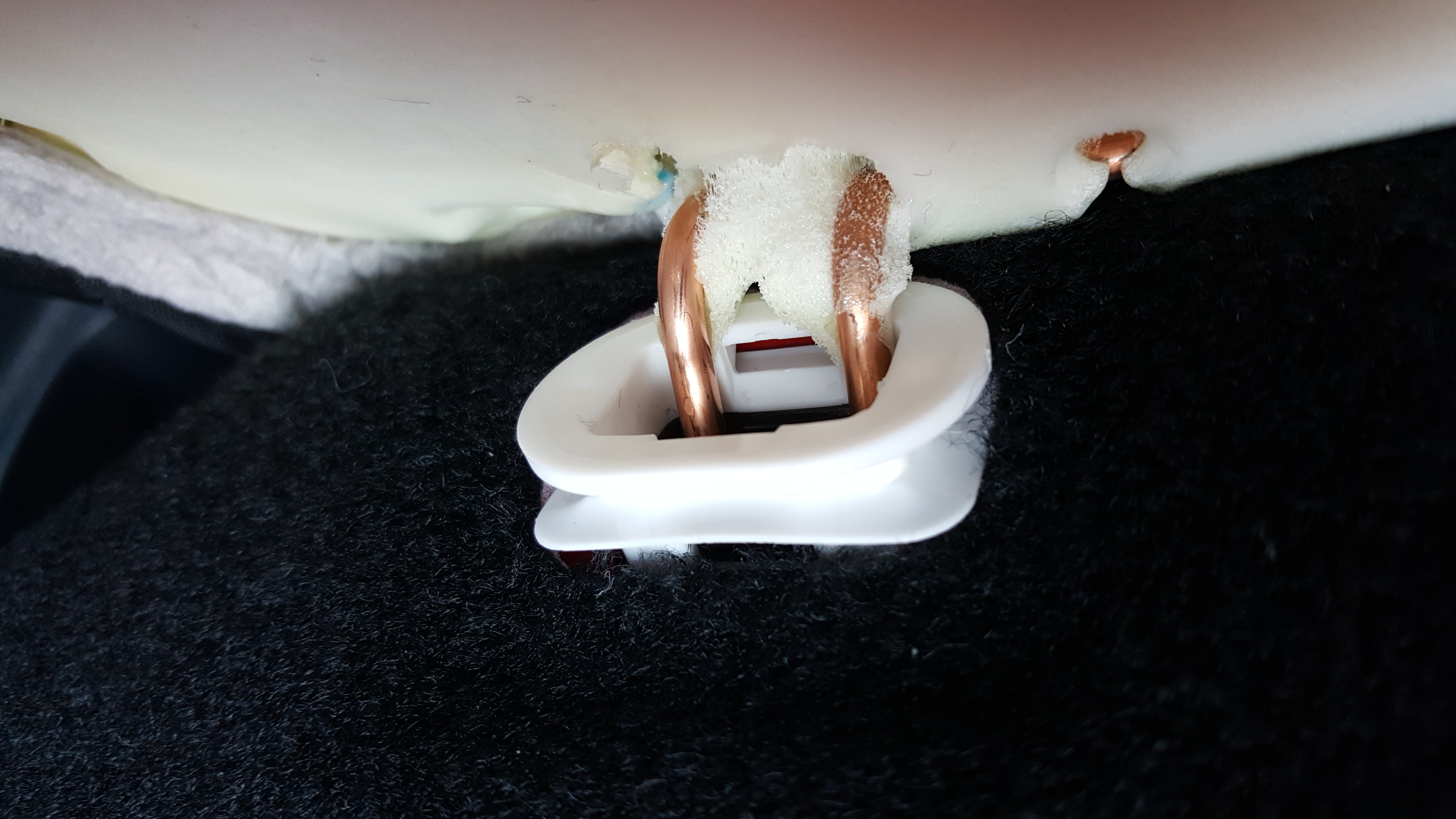

Now stuck on these clips though. Do they actually come off?
  • 3 years later...
I used a small pry bar levered on a piece of 12mm ply to lift the copper clips out - I didn't want to break anything by just using brute force.
