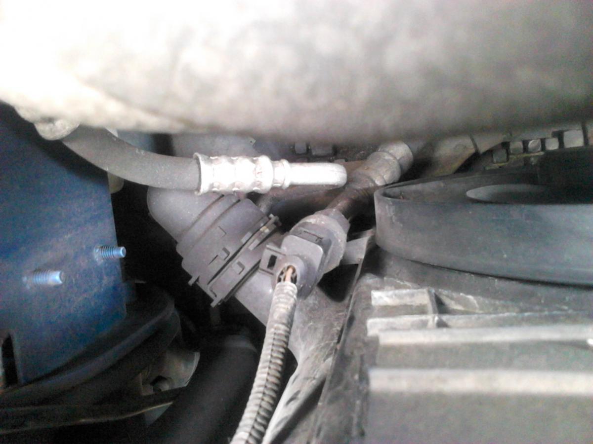

  • Thanks again Erindad, but those numbers don't tally with the ones on the link (or on my car)...   http://www.my-gti.com/224/volkswagen-climatronic-diagnostics   The main channel only goes up to 30
  • Cheers mate...will try changing that first...just need to go and get a 17mm crow foot spanner now !!!
  • UPDATE.....I AM COOL  ....no I don't mean I've suddenly become a trendy type......I mean I now have working aircon again !!!   Huge thanks to MATTVRESTATE who whipped the inner wheel arch liner off

Just wondered ( I'm no a/c expert ) if the pressure is reading low could it be a faulty pressure sensor. Mines coldish but i can't say I'm too impressed with it. I'll be changing mine soon although it looks like we've had our 3 days of summer here! !
Are you referring to this ?? ...
10 – 1 Liquid refigerant pressure bar 06.  0
If so, is 6 bar too low, and if it is, where do I find the pressure sensor ??
I'm not clued up on aircon, mine is rubbish too so we're in the same boat here. You mentioned in your first post your brother in law had serviced the system but it wasn't very cold. Mine is ok and this may be quite normal for these but it's not freezing cold like i think it should be. If he's serviced it for you he will have regassed the system so i would have thought the pressure would be higher than the system says. It might be a faulty pressure sensor but you don't want to go down the route of throwing money at it blindly. I got into the climate settings yesterday following the link and mine was reading 12bar pressure and mine has just been regassed last week. A few people on here have mentioned poor air con temp and after changing the pressure sensor all was well again. So I'll be doing that soon as I'm fairly certain the compressor is fine.
The pressure sensor is near the front of the engine bay next to the left hand cooling fan as you look in from the front. You'll see the black connector going to it. I tried taking a picture but its in a difficult place. A 17mm crow foot spanner is needed to remove it.

Cheers guys.....meaty101, re the pressure sensor, I have taken a pic of what I think you are referring to (attached..hopefully !!), but when I undo it, will all the gas escape and then need refilling afterwards  ??
Erindad...just been and checked the pressure again at 10-1 and it stays around the 5.6 bar mark regardless of whether I rev the engine or not - albeit the engine is cold - but not as cold as the ambient temp. which is currently displaying as minus 17 degrees, so is this wayward temp. preventing the aircon from kicking in and the pressure increasing as you say it should ??
Yes I'm certain that's the pressure sensor well it's what I'll be changing!! I've never changed one but apparently there is a valve that the sensor pushes onto and opens when tightened ( like a tyre valve ) so unless the valve is stuck open no gas should escape.
