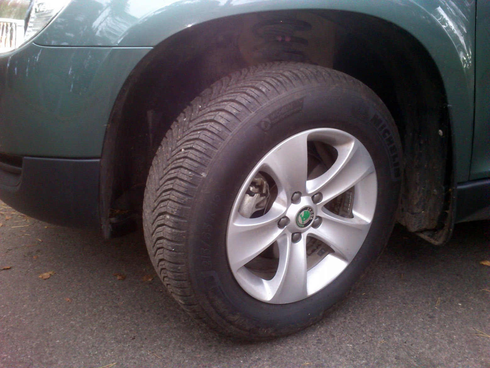

  • Here's our Yeti on 215 65 R16 (Michelin CrossClimate):       (Sorry about the quality...)

Are the 65 profile an OEM size I was under the impression a 60 was max you could go to stick with manufacturers specs on a 215/16 ie 215 60 16.
Sure they would be fine to use plenty rubber between road and wheel rim.
Check out tyre rim calculator this size would increase overall size of wheel and tyre might affect gearing slightly and possibly speedo reading, I am no expert but been researching for my own winter tyre fitments.
I had a look on e tyres and they say plus or minus 2.5% the 65s are 4.41% a 29 mm increase in diameter.
Edited by ywyetinym
Most likely to have the Speedo reading more accurately, ie correct speed rather than as from the factory and speedo showing your speed as higher than actually travelling at.
Easy enough to check using sat nav when travelling at a constant speed and comparing GPS / Speedo.

Yes I think your probably correct It seems most car speedos read fast although Its a nice cushion If you ignore that fact and like to stick to the 20s 30s and 40s speed limits not sure how far out they are further up the range.
