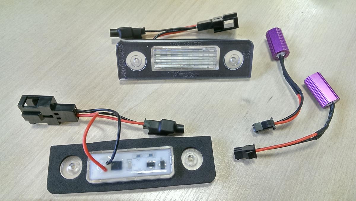

Added LED licence plate lights today, they are pretty damn bright...
They cost £13 from here http://www.aliexpress.com/item/Canbus-LED-License-lamp-For-SKODA-Octavia-1Z-Roomster-5J-LED-License-Plate-Light-auto-car/32266687563.html but look identical to these http://www.superskoda.com/Skoda/OCTAVIA-II/Octavia-II-09-12-facelift-MEGA-POWER-LED-licence-plate-light-system-KI-R despite the price difference.
I haven't used the included load resistors and once I disabled PWM (CECM, byte 17, bit 7) I've not had bulb warnings. They are also E marked which is a bonus!

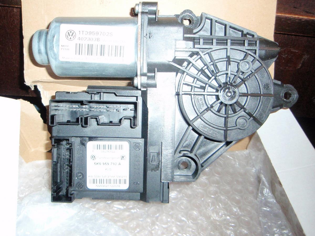

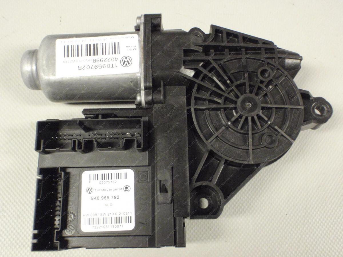

Sorry can you give me some more info and parts used for the folding mirrors
Sure, for my car I needed:
- left folding mirror
- right folding mirror
- mirror control knob with folding function
You also need to check what door controllers are fitted as not all support folding mirrors. Mine fortunately did but if yours don't they'll also need replacing which can seriously bump up the cost. I also added a memory module to the passenger side so it supports 'reverse dip' properly too.
I sourced used parts to keep costs down and reused the plastics and mirrors from my originals. Mostly as a new mirror is about £250 per side from a dealer...

Will the mirror dip retrofit work on mine? Also can you share the details of the parts required for the mirror dip please?
Edited by singh946
I don't think yours will support reverse dip, mostly as it's missing the pins needed to talk to the new mirror motor.
1T0 959 702 R:
1T0 959 702 S:
Assuming you have got a 1T0 959 702 S fitted, then you need to replace the mirror motor with 3D0 959 578 C (I think this is the right part) and add the extra wiring between the door module and mirror motor. This only needs to be done on the passenger side as there isn't a reverse dip function on the drivers side. After fitting, it needs coding :)
1T0 959 702 R:
1T0 959 702 S:
