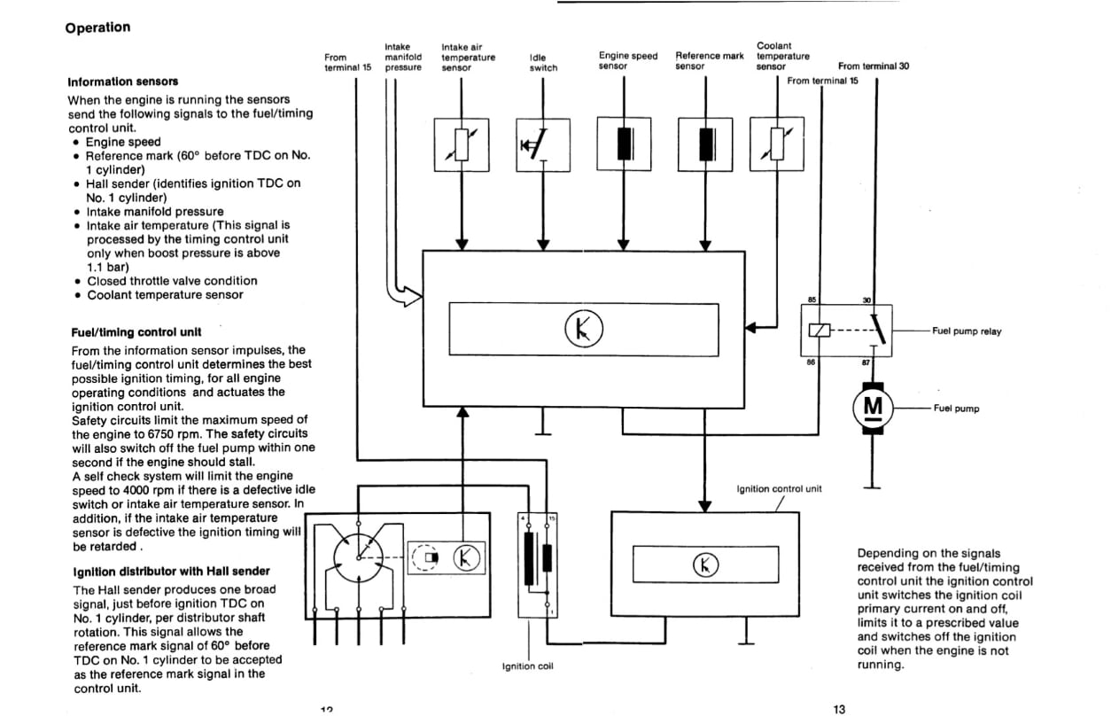

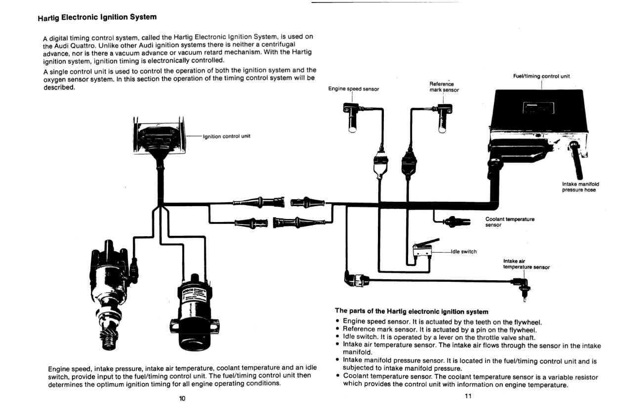

This is my intake air temp sensor which after some troubleshooting a while ago I assumed was faulty. The car cuts boost at about 4500rpm.
Working with Neill at roissy.co.nz today we cleaned and tested the sensor, and proved it's working as it should. Back to the drawing board there!
107666579_2640241806076099_9442577386581

Any news on the boost cut issue, or is that ongoing Rob?.
Christ, that 5 years went by quick.
That's ongoning. I've proved that the intake air temp sensor works and the wiring is good, next step is to do some more wire and sensor tests.
