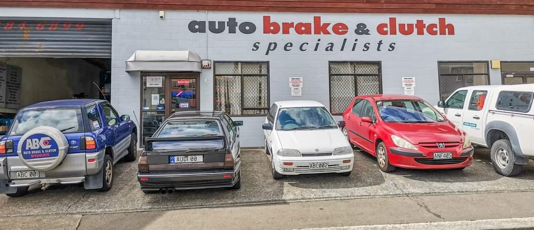

So I'm kinda over it now. I've dropped the car at Auto Brake and Clutch who fixed a mate's Coupe quattro ABS a while back.
Always good when the business owner says "You know it won't be cheap, right?"
120014354_2833819133385031_7908643850684

Noooo you are too close to the that Suzuki, it may 'dink' your door....MOVE IT NOW...IMMEDIATELY...I WONT SLEEP UNTIL I KNOW IT'S SAFE!!!!!
Ooh thats a bit touch and go. Somewhere near the maximum arc of the Suzy and the Toyota door swings. I'd get them to move their cars. Seems only reasonable
Hope this helps :)
Edited by Lady Elanore
The parks were at about 35 degree angles too, glad my handbrake works.
