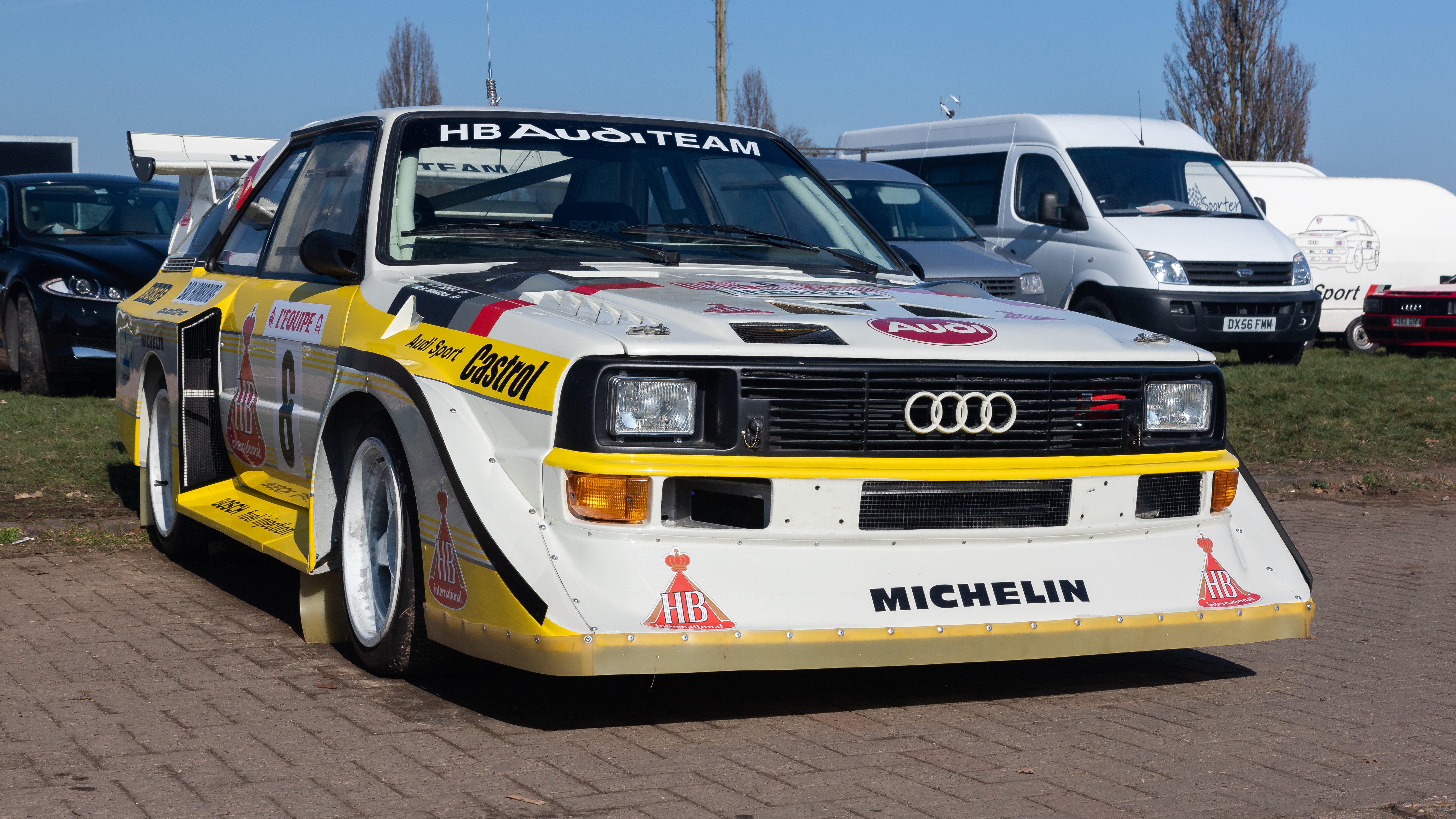

See I told you white wheels were the way to go :D

Rob click on the first picture to see it in it's full white wheeled loveliness. To be fair it sounded better than it looked. The short wheelbase is not a nice as the earlier versions. Tried to find the owner to see if I could offer him some sweeties in return for a spin in it :D
