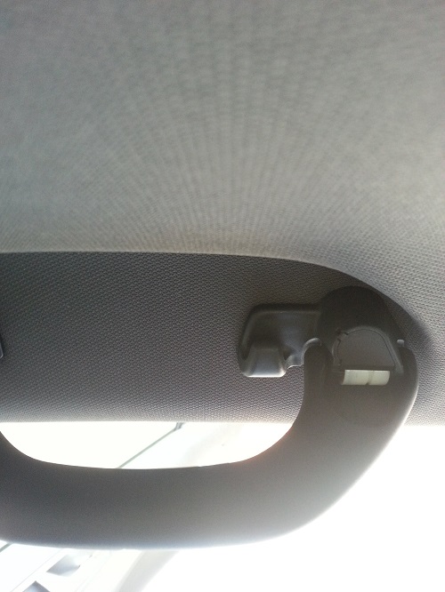

Soft Touch Passenger Grab handles?

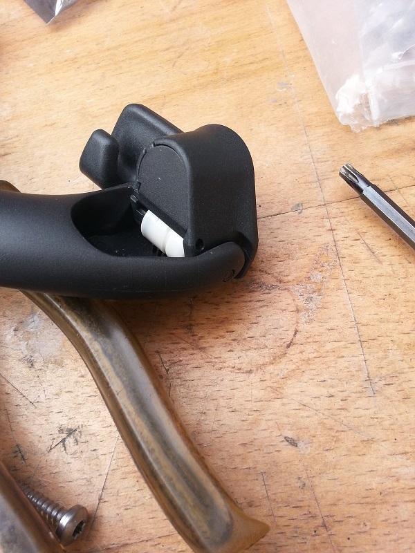

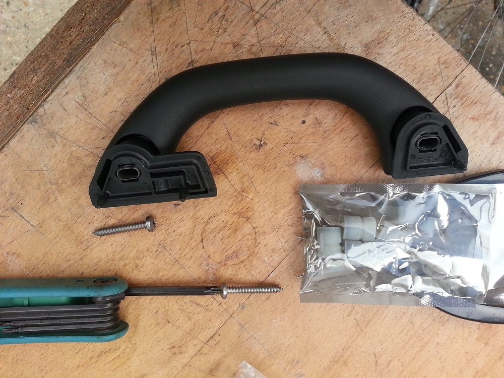

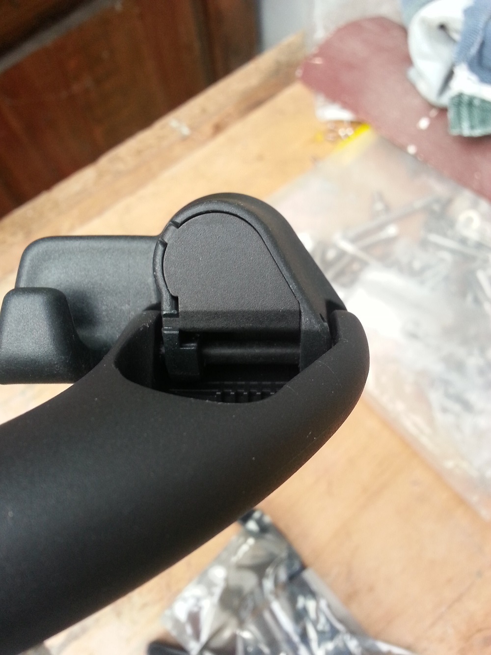

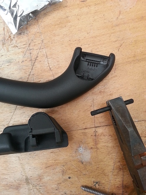

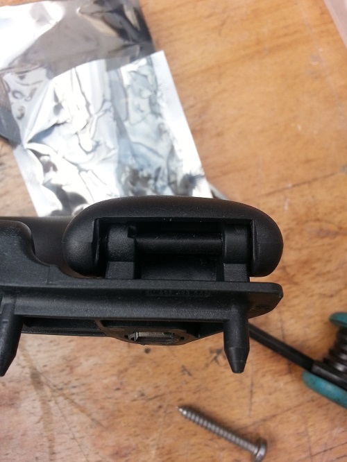

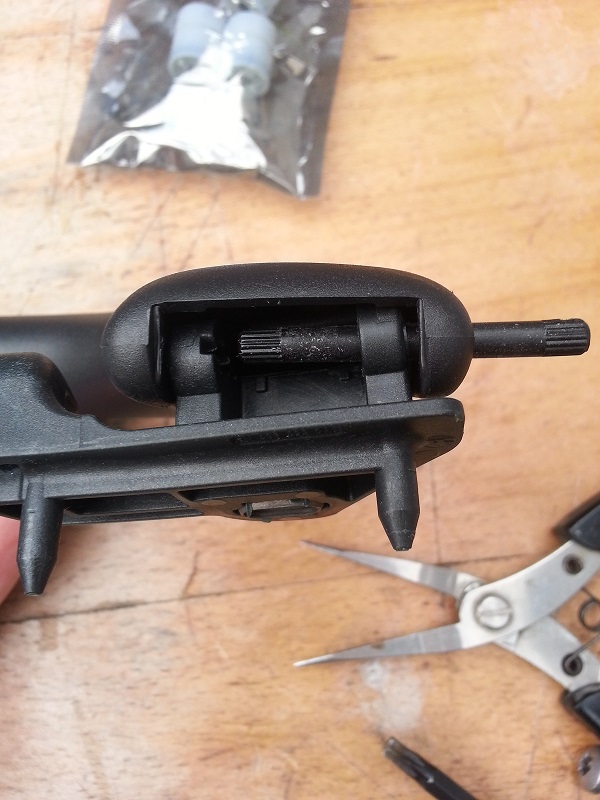

  • the pins are just a push fit - I used a set of small thin needle nosed pliers to get mine out, but if you take your time it's actually quite easy. I thought it prudent to start on one of the rear o

And thanks for the guide. Were the pins glued / sealed in at all or is it just a good push to get them out?

the pins are just a push fit - I used a set of small thin needle nosed pliers to get mine out, but if you take your time it's actually quite easy. I thought it prudent to start on one of the rear ones first in case I made a mess of it!

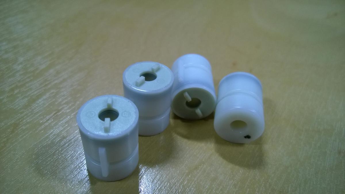

Presume you only need 4 items, rather than needing 8. So this would mean only 1 damper in each handle?
That's correct - 1 damper per handle, but they come in a pack of 4 anyway.

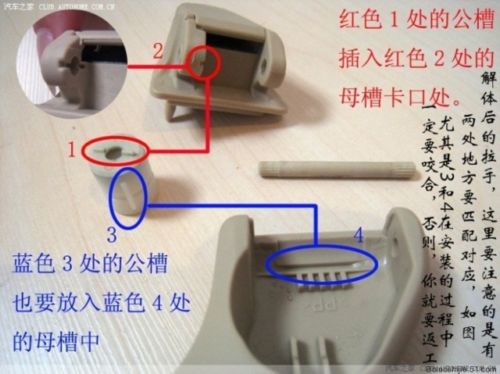

Mine arrived yesterday but the damping is too strong, at least on both front handles as I haven't done the rears. They get about halfway closed and stop unless I push them closed.
Also, unlike this image, the groove labelled 2 only extends on one side of the mount rather than both. Anyone else had this?
How do you mean? Going by the picture it looks as if the grove should only be on one side....or do you mean that in the round picture the cut out only extends to one side on that side of hole?
The dampers themselves have tabs that extend either side.
I will check mine later and report back.  Guessing you could either cut one side of the tabs from the dampers, or better still make a grove in the handle.
The cut only extends to one side of the hole so I removed one of the tabs from the damper otherwise they wouldn't have fit.
