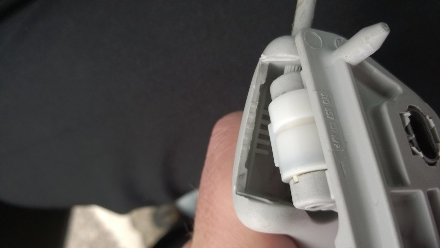

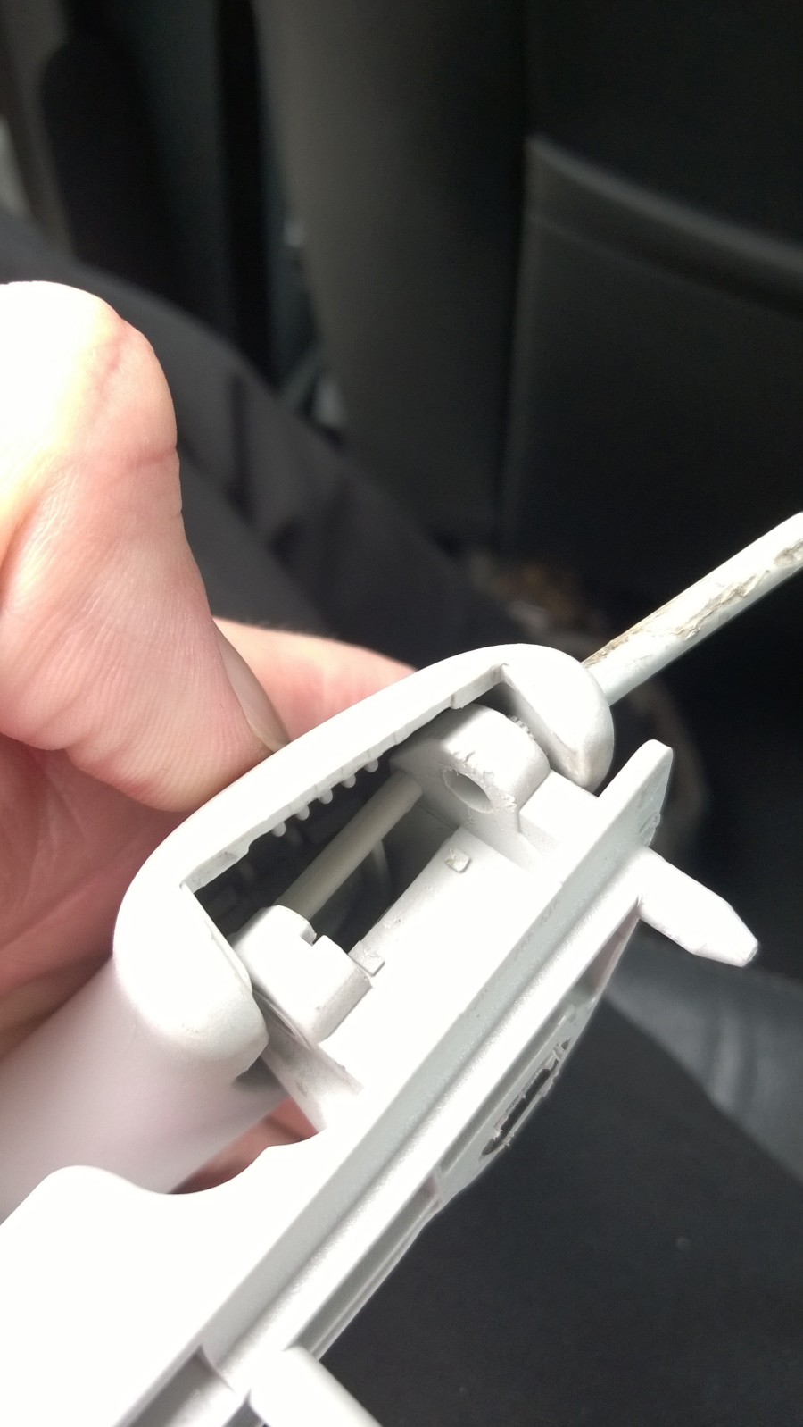

  • the pins are just a push fit - I used a set of small thin needle nosed pliers to get mine out, but if you take your time it's actually quite easy. I thought it prudent to start on one of the rear o

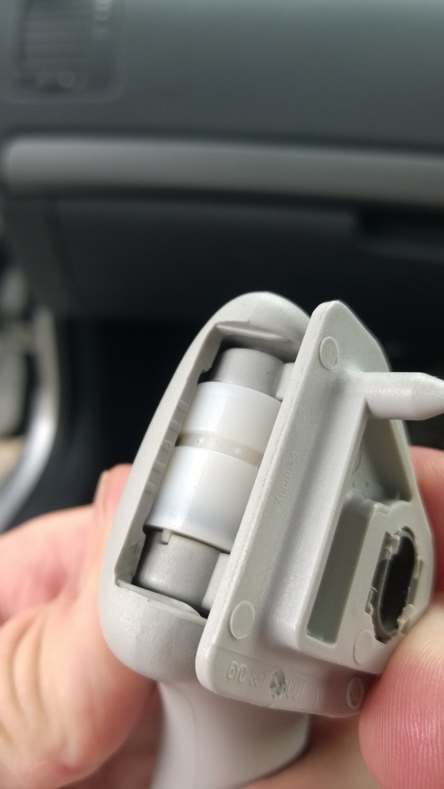

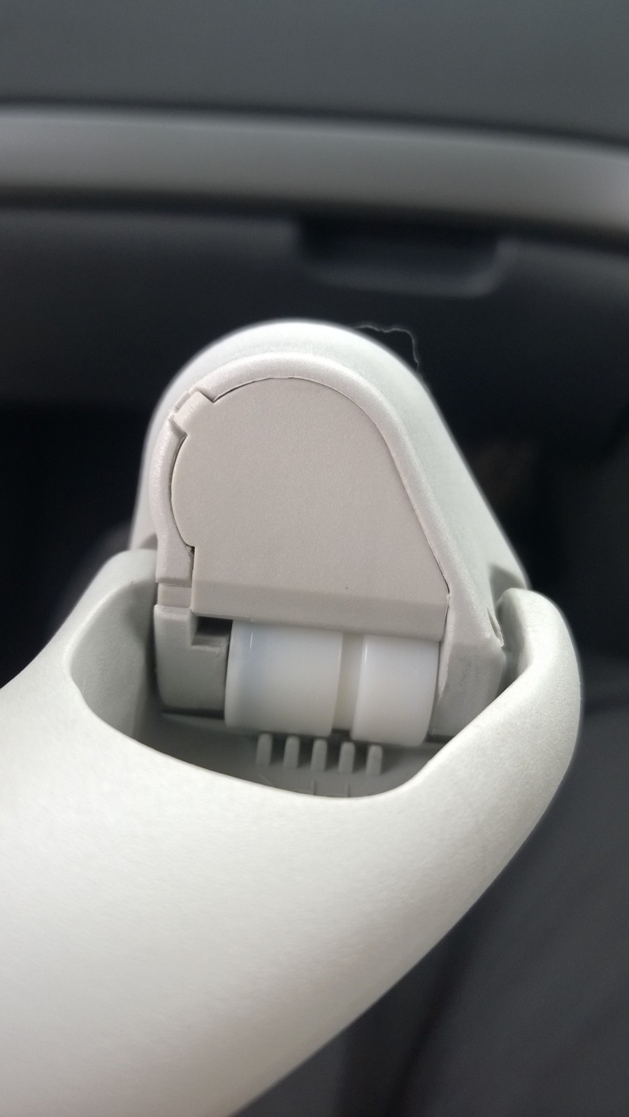

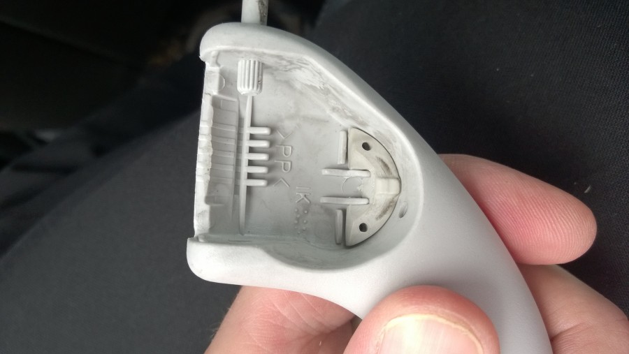

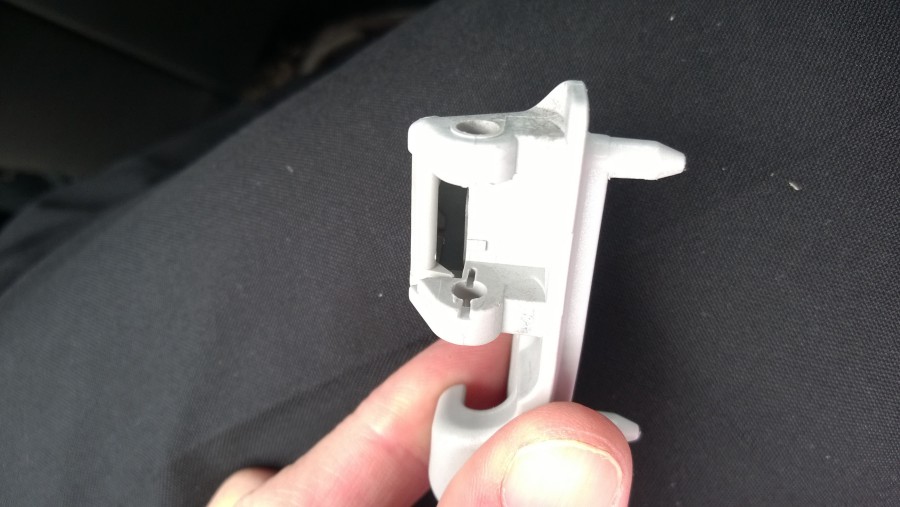

Now sorted - Make sure that the long ridge along the round body (3 in picture above) is correctly seated in the groove on the handle (4 in picture above).

All done and dusted now. Two pins came out fairly easily, one was a bit tougher and the final one a real PITA!
However, all fitted and working as they should.

As mentioned, ensure you get them all lined up correctly before insertion. I bet they would be a nightmare (if not impossibe) to remove them after you have replaced the pins, should you want to that is.
The pins themselves were pretty hard to remove from mine. I did have the double cut outs around the pin hole too.

Mine arrived yesterday but the damping is too strong, at least on both front handles as I haven't done the rears. They get about halfway closed and stop unless I push them closed.
Also, unlike this image, the groove labelled 2 only extends on one side of the mount rather than both. Anyone else had this?
Er.. not me - I know what you are saying, but the groove was on either side (both sides) of mine and it went together fairly easily once I had worked out exactly what went into what groove..
The cut only extends to one side of the hole so I removed one of the tabs from the damper otherwise they wouldn't have fit.

Tried to do my first one last night and gave up after about 15 minutes trying to get the pin out. Only managed to move it by about 1mm in all that time.

For me I just had to use brute force. Couldn't find a knack but just used needle nose pliers and used the thumb on the other hand as a leverage point.  Once you have enough of the pin out you can grab the end and pull from there.
As you can see from my pictures I did scrape the pin a bit which was showing the amount of force used.
You could try a tiny bit of WD40 on the end that comes out first perhaps?

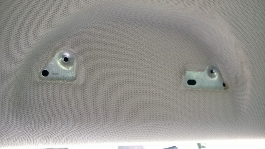

Thanks again for the heads up, fitted mine today. Took longer to work out how to release the handles from the roof, as they are clipped in on the Yeti, than to fit the bits. Well chuffed at the result.
I was surprised the Yeti handles weren't screwed in as well. Pretty easy to remove when you know how - and no screws to drop!
My pins were either fairly easy or ridiculously hard. Scraped quite a lot of plastic off one in particular. Brute force and big pliers to get enough of the pin out to pull from the end.
Keeping it straight helped on most as the slightest angle off on pulling the pin made it really hard.

Same as KBPhoto says above, no screws, the handles are held in with spring clips.
Flat screwdriver above the top one and another below the bottom one. Pride the drivers apart to squeeze the two tabs together then pull the handle away from the headlining.

I did mine so long ago that I can't remember doing them.  I recall I botched the first one (I had no instructions at all) and it was interesting removing the pin a 2nd time.  The long tab seated properly in the handle is essential or it won't work

Just done this on our Octy and Yetis - great mod and not too bad with the exception of one particularly stubborn pin on the Octy.  The other thing I'd say is to only push the pin back in half way and then double check that the damper has fitted properly in the correct slots beofre pushing the pin home, because once the pin has been pushed back home fully you'll never get it out again.
