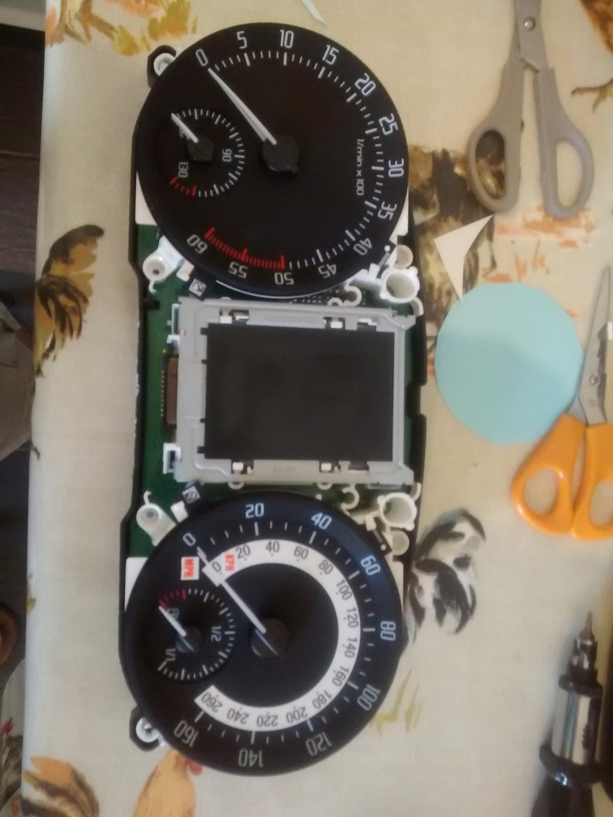

Finally sorted it out, I removed the instrument cluster and the part number was the 5L0920840, looking it up the cheapest I could find was ~700€.
So I went for the cheapest option, I found on ebay someone selling stick-on number dials for about £12, when they arrived one of them was exactly the right fit to match MPH and KPH, so I took the cluster apart and put it on, it does not look great but it did the trick, the car passed the ITV !!! and I now have Spanish number plates, I cannot see it in the dark but I use the digital display anyway.
I am going to ask someone to change the display to the large one next tme I visit the UK.

Excellent solution. Much cheaper, and no configuring/coding/matching required, which would have been required with a replacement cluster, I think. :thumbup:
