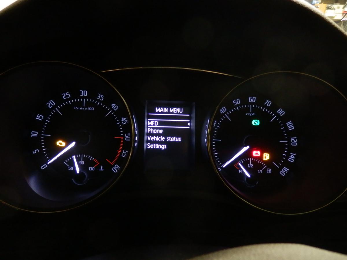

I have noticed that some people seem to have a Audio and a Navigation in their Maxidot. Our dash is only showing MFD, Phone and Settings. I have the large number for MPH activated. How can I get the dash to show other 2 - Audio and Navi?
I assume you have SII L&K and I'm surprised why you aren't able to see Audio, Nav etc...sounds like Columbus and cluster are not talking to each other. Not sure if there is some sort of bug requiring software fix!

I have been reading across the internet and seen pictures of maxidots WITH Audio and Navigation.
I do not have a compass showing in the top corner at any time no matter whether the radio is on or off. There is not even a Navigation display when I am navigating with the sat nav other than on the Columbus radio itself. And the Audio does not feed into the maxidot.
Thinking back, when we bought the car I am sure I could see a radio station in the dash display, but I am not too sure.

I have attached a picture of our maxidot.

That's maxidot. I reckon the nav and stereo just needs adding to the gateway installation list, but it will need someone who knows about VCP to say how that is done (in VCDS it is as simple as adding ticks to a list in module 19).
The dealer is talking rubbish!!! Wouldn't be the first time I suppose. They often don't know what is/isn't possible. Mine swore blind that I could not fit the Columbus in my car when I ordered the facia trim from them.
As above I would check they're both ticked in the installation list then go into the stereo and check that it is in the right mode (DDP/BAP- should be ticked for BAP in your car) and also check that the right display is chosen. There's an option to choose what kind of dash screen is there- should be high line or something along those lines.

One problem was the BAP not activated.
I have put the VCP on and I set the BAP and have got Audio and Navigation back in the Maxidot display.

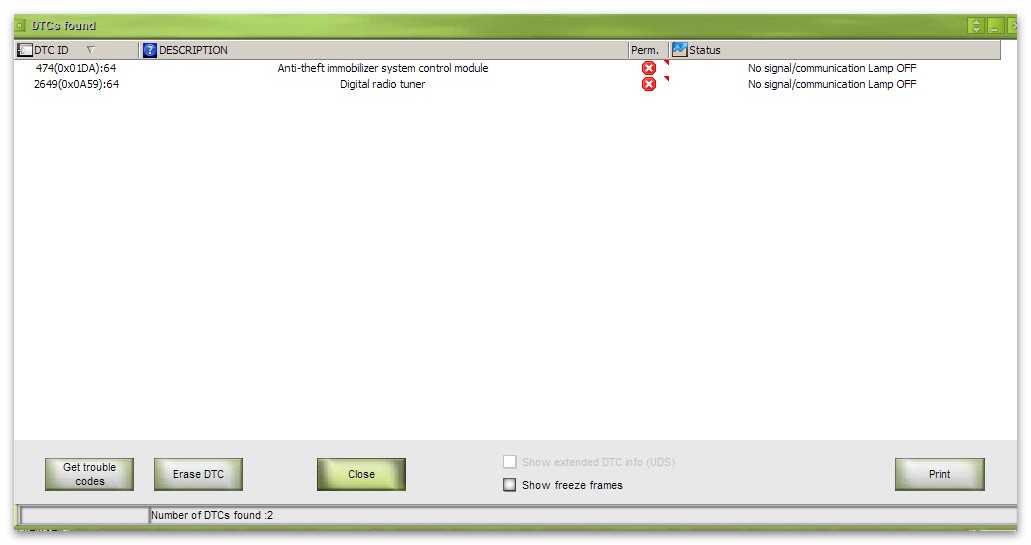

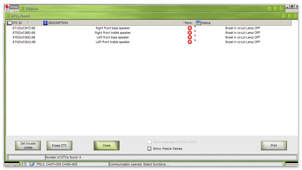

But I have also got a DTC with Radio and Navigation that I am missing 4 speakers. However when I do the output tests ALL speakers respond.and the sound is good.
The scan is showing a lot of communication errors. I did the scan with the engine off but only thought of this afterwards.
I have attached the scan file and a couple of screen shot jpgs with the DTCs.post-133229-0-80206800-1444511979_thumb.jpgpost-133229-0-01616300-1444511991_thumb.jpgautoscan_20151010_2135.txt
