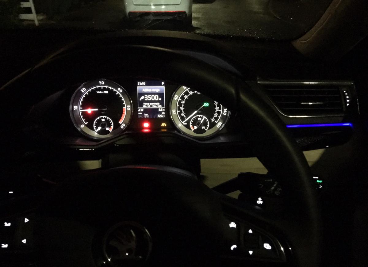

After having another mess about with the car today, I might have POSSIBLY come across how to enable the clocks to light up with the sidelights on.
Enable illumination of dash clocks with sidelights - not just the needles.
17: Instruments > Adaptation > (1)-illumination_algorithm-Scale_switching_algorithm
Set stored value to 'Ids',
I've just been outside in the pitch black, started the car and then switched to side lights and the clocks stayed illuminated. That would suggest it worked.

No request for an access code.
I've just toggled the adaptation back to 'parking_light', then back to 'Ids' and it accepted the changes every time.
There is, however, a spurious databus error on the Instruments controller. Not sure if it's a result of altering this setting, or something else i've been experimenting with (oil level display). I'll investigate when I get a spare minute.
