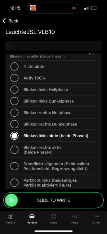

Hello,
Have someone coded dynamic turn signals on Skoda Superb III Non facelift model. I have tried something but its not working, chat gpt says maybe it can be coded.
Lool, interesting that people are playing with their cars according to info from ChatGPT.
Well, hopefully you will stay with the lights and not go into ABS module or something. Because that could be much more damaging, maybe even leathal.
And no, you cannot code them. (not from a smart ChatGPT, but only a normal dumb person).

Dynamic indicators is "Rollenblinken" in Stg 09.
You are coding your side lights - SL.

With a MY19 Kodiaq, I can't remember if the rear blinkers are splitted on both the boot and the rear wings.
If they are, then all what you may be able to do (with a genuine cable 😉) is to activate rear blinkers in opposite phases for both parts on each side.
I've no idea of how to do it, but I remember I've seen this on a Golf Mk6 or Mk7 on YouTube.
May be someone played with a Superb Mk3 estate too and set this mode but using tail lights as blinkers as in the US. But I don't think it is street legal in Europe (whatever the country).

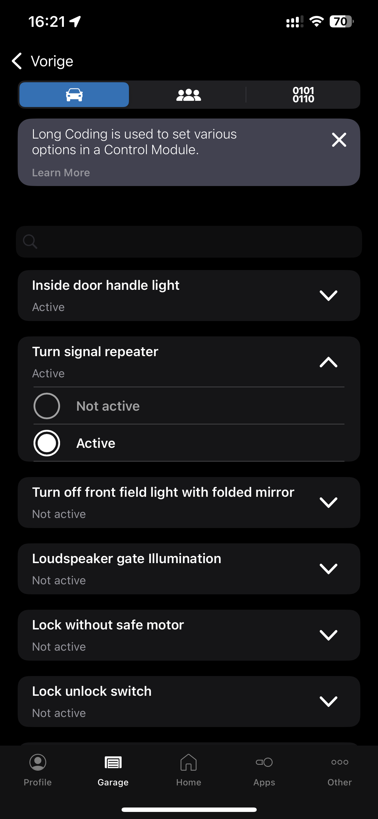

This a screen shot from ODIS in Stg 42, driver door controller. Turn signal repeater is what you are looking for, but you can not modify it like other lights in Stg 09.
Indeed i found this but can only put this active or inactive. However its strange there is nothing in 09 referring to this light?

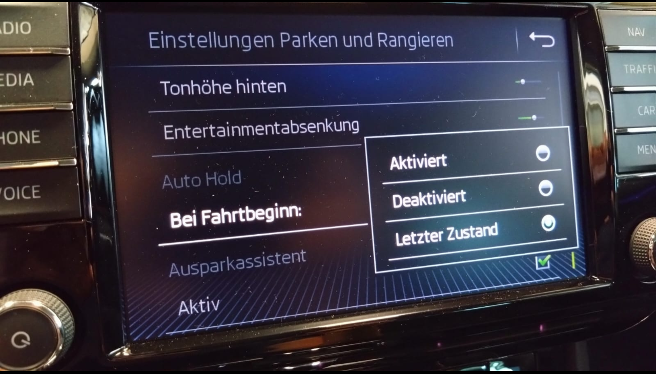

The Auto Hold function has been integrated into the HMI...
On 11/08/2025 at 04:40, Cairus said:
What is the coding for this?
