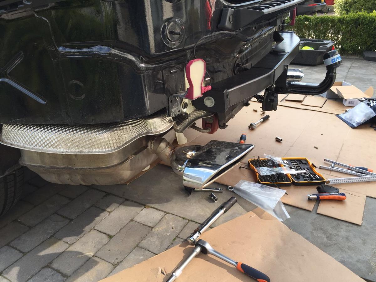

I found 2 radar sensors at the rear from a superb3. Are those for rear traffic alert? This s3 doesn't have this option but I can't found out yet what those are for.
Any ideas? Forgot to check the numbers on it
Edited by Antera
Side Assist maybe?

The U.K. speck L&K has rear radar for parking bays etc fitted as std.
Blind spot detection. It works with rear mirrors. Its on the manual.

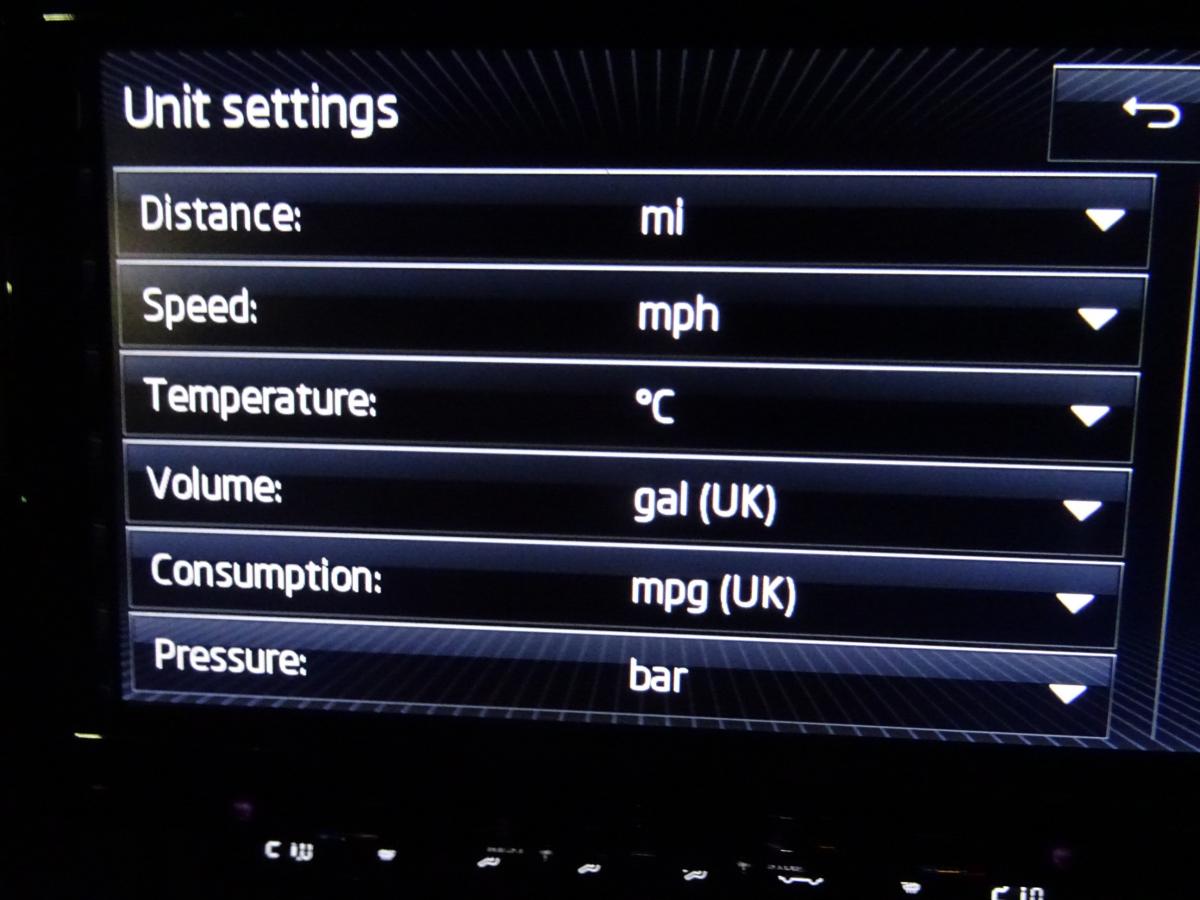

Can the odometer be changed from miles to kilometres and back like in the Honda civics? Can this be done by VCDS?
VCDS not needed. All measurement units (speed/distance/consumption/volume) can be individually switched in the infotainment's CAR menu.
Thank you BillyJim. That opens loads of options on where I might buy the car

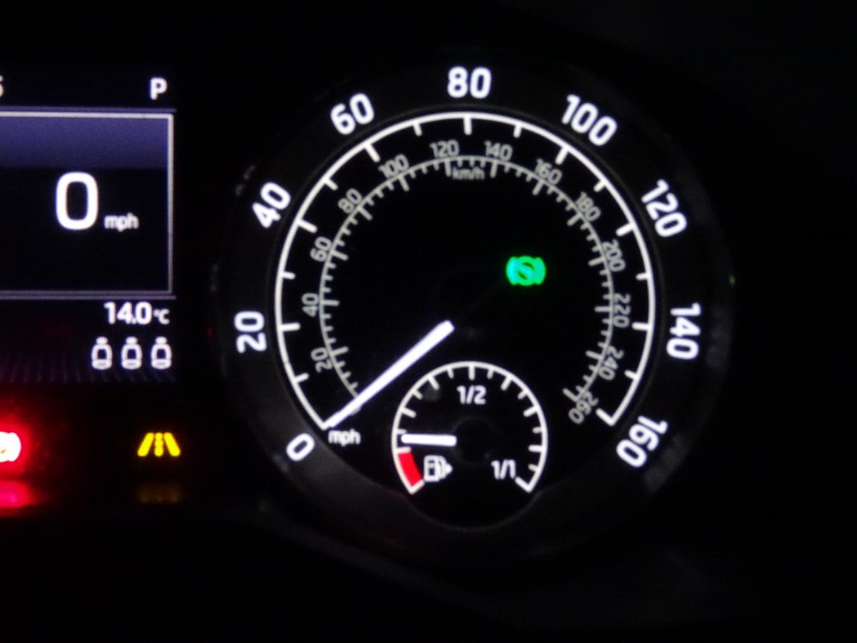

Don’t forget the speedo dial will only be in mph OR kph though
That's not actually the case. Unlike the Superb II it now has a "normal" dual-value speedometer dial with mph outer and kph inner.
I don't think mine does

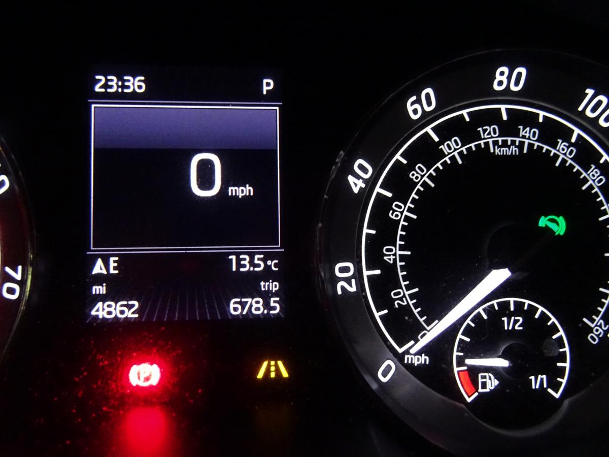

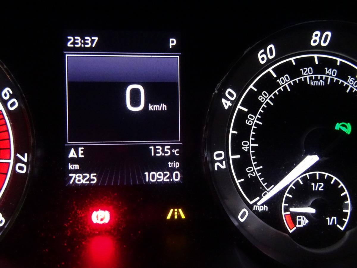

Would someone mind putting up a photo of the odometer please? Thanks
Is it just the 280 then?
Miles & MPH (digital speedo)...
and, one minute later, exactly the same as Kilometres & km/h...
and finally the infotainment "Units" screen...
