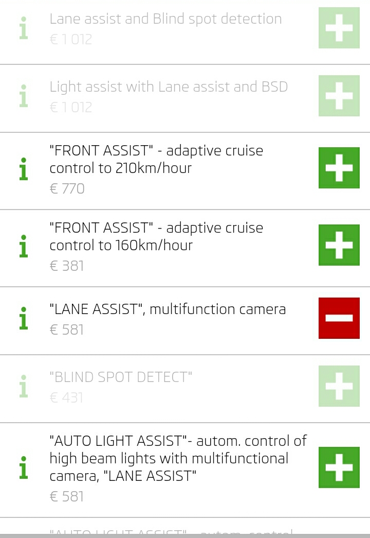

In trying to understand vcds, can someone tell me by opting for "Lane assist" multifunction camera, what options can vcds switch on for me?
Cheers
Most probably (not 100%) Traffic Sign Recognition and Light Assist, if you do not order Smart Light Assist.
Are any of these options available by vcds after picking "lane assist" multifunction camera?

Try with deleting the fault codes and resetting the camera.
The last rule is not (always)right. I found out that the S3 i had you have to change in module 44 Byte 3 Bit 0. See attachmentattachicon.gifLane assist.png
Hello folks, i coded this today and it worked! I rebooted radio as gizmo said by holding power button for 10 seconds and i reset all the faults that were generated afterwards. and it worked so thanks again for the help and of course the patience. i tried it on a short drive and it identified to white lines and corrected to get to the center of the lane not as fast as i thought it would though. I read somewhere on the forum their is a setting you should tick some thing like predict the lane or extrapolate anyone see this?? I took screen captures of each step but cant figure out how to attach.

You can see I can only activate lane control their is no predictive box to checkk? I must have missed some thing but I double checked the guide above. I flicked through all the relevant modules but could not see some that looked relevant to my novice eyes[emoji23]
