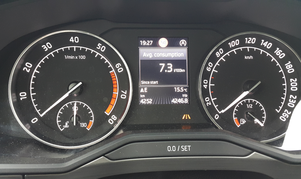

VCDS options on Superb III
Miles & MPH (digital speedo)...
and, one minute later, exactly the same as Kilometres & km/h...
and finally the infotainment "Units" screen...
Perfect.
Many thanks BillyJim
