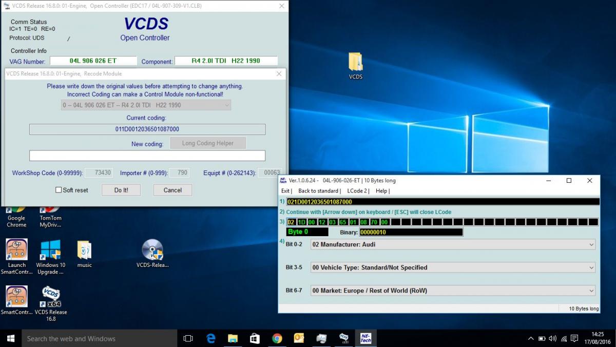

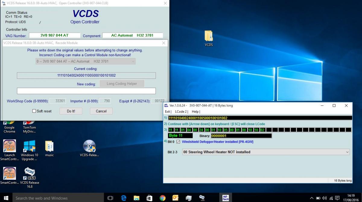

Got my VCDS cable today and couldn't wait to start, but I've had a few issues.
The only things I've successfully added is refuel quantity and auto change clock to summer time.
It wouldn't accept the coding for the Audi throttle mod.
The blower display in auto does not have bit 6 listed in the long coding helper
And high beam assist, when i look for the adaptions, "assistant light functions - menu light assistant" isn't listed. There are a dozen or so "Assistant light functions -" listed, all with German descriptions after the hyphen.
I was following the adaptions tried and tested thread and I suspect its me being a numpty and new to VCDS so any help is appreciated.
Car is SEL150, with the TSR camera.post-140172-0-70663400-1471443165_thumb.jpgpost-140172-0-82532600-1471443195_thumb.jpg
Activated Audi as manufacturer, but have not felt that much of a difference. Definitely not when coming to an alomost-stop and wanting to start moving again. Still felt like it took ~2 seconds for throttle to respond at all.
I guess i'll see how it feels for a few days to judge more.
Maybe the diesels respond better to this change. My 190 is a different car for changing over to Audi.

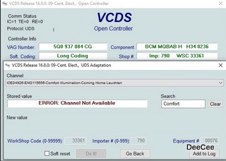

Tried a few changes to my MY17 190 L&K Superb using VCDS Beta 16.6.
Working....
Coding Eyelashes always on in the headlights S3
Post #20
http://www.briskoda.net/forums/topic/380829-superb-mkiii-vcds-adaptations-tried-and-tested/#entry4631216
Automatically change clock to summertime (Coding accepted, but not yet tested)
Post #15
http://www.briskoda.net/forums/topic/380829-superb-mkiii-vcds-adaptations-tried-and-tested/#entry4537913
Activate ‘Off Road’ display
post #18
http://www.briskoda.net/forums/topic/380829-superb-mkiii-vcds-adaptations-tried-and-tested/#entry4579559
Still Not working....
Foglights as coming home lights(Error Channel not Available)
Post#9
http://www.briskoda.net/forums/topic/380829-superb-mkiii-vcds-adaptations-tried-and-tested/#entry4460950
UPDATE......
Now using VCDS V16.8...
'Off Road' working, but Foglights as coming home lights showing 'Error Channel not Available'
UPDATE......
Log it with Ross-Tech.
There are problems also with accessing some other channels in MY2017 cars.
