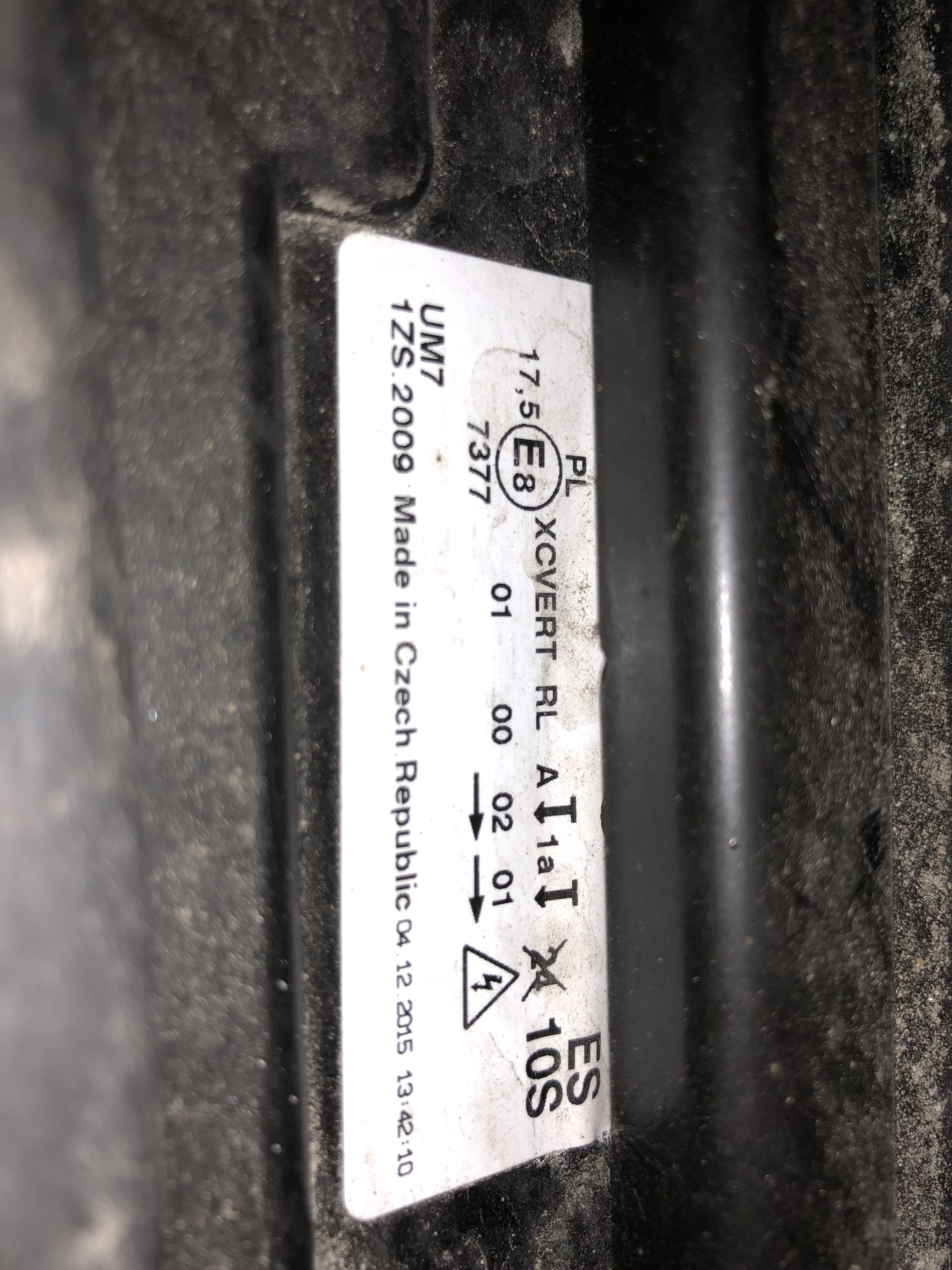

1 hour ago, Gizmo said:
Welcome @Glenn_DK
Look for a sticker on each headlight.
Thanks @Gizmo I have read a lot of your useful info now... and started make some “upgrades” ;)
Have change the settings but nothing happens.

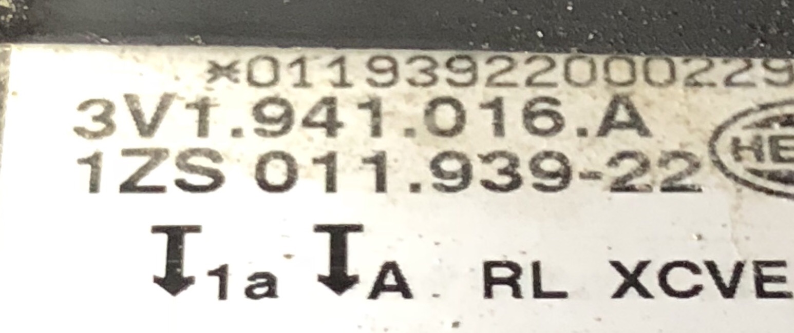

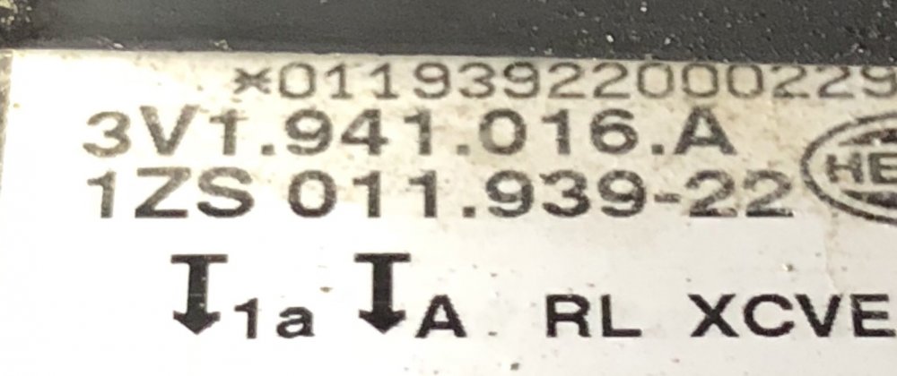

The 3V1 941 01* A or B is just above those numbers if yours ends in A then the whiskers are not present.
Unfortunately, it was A model :crying:
