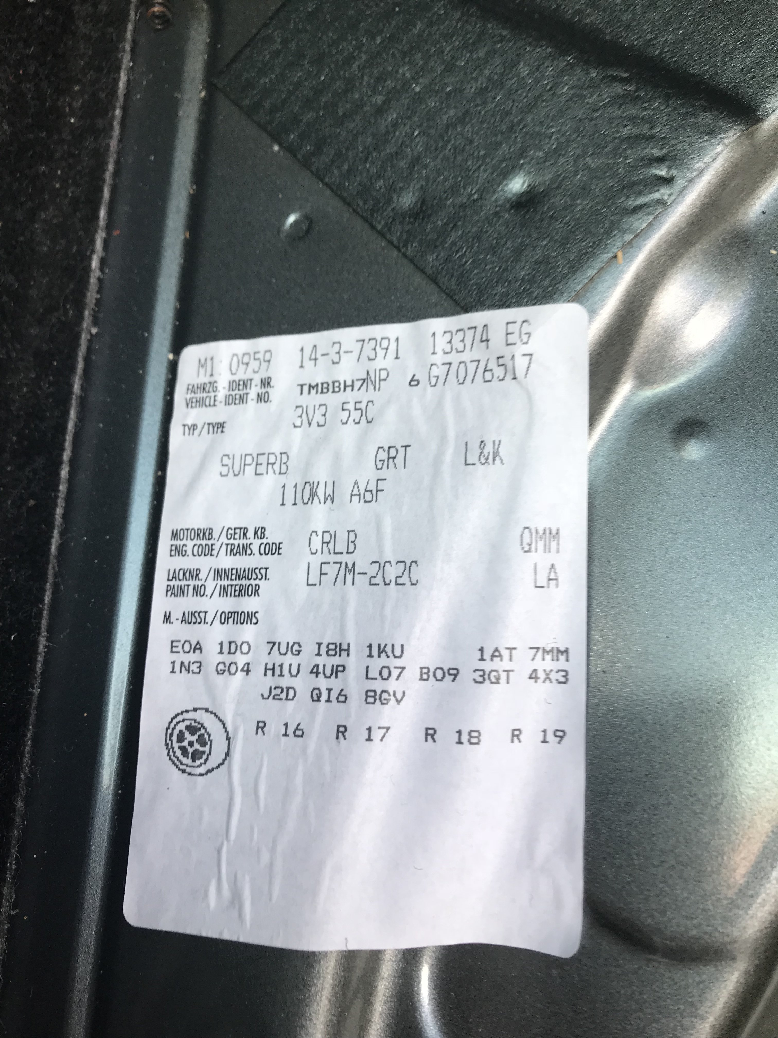

Could someone tell me what options mine has please.
