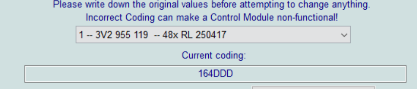

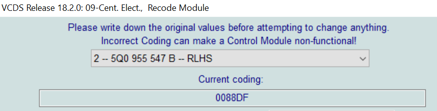

In Controller 07; Coding 07 I see a drop down which presents three sets of values so I dont understand what Block B7 is ???
Capture2.PNG.3c333d677bfaceacd458d961756ed84d.PNGCapture3.PNG.c34b06cf63396ff694681f3de22d2393.PNG

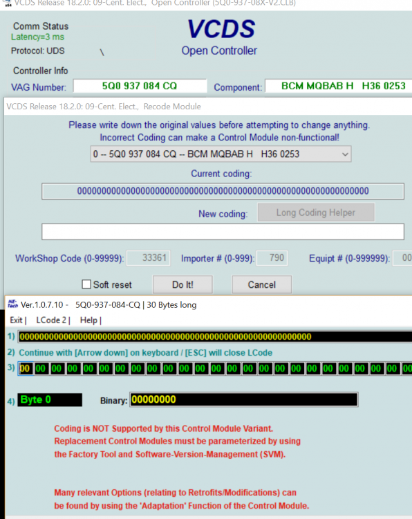

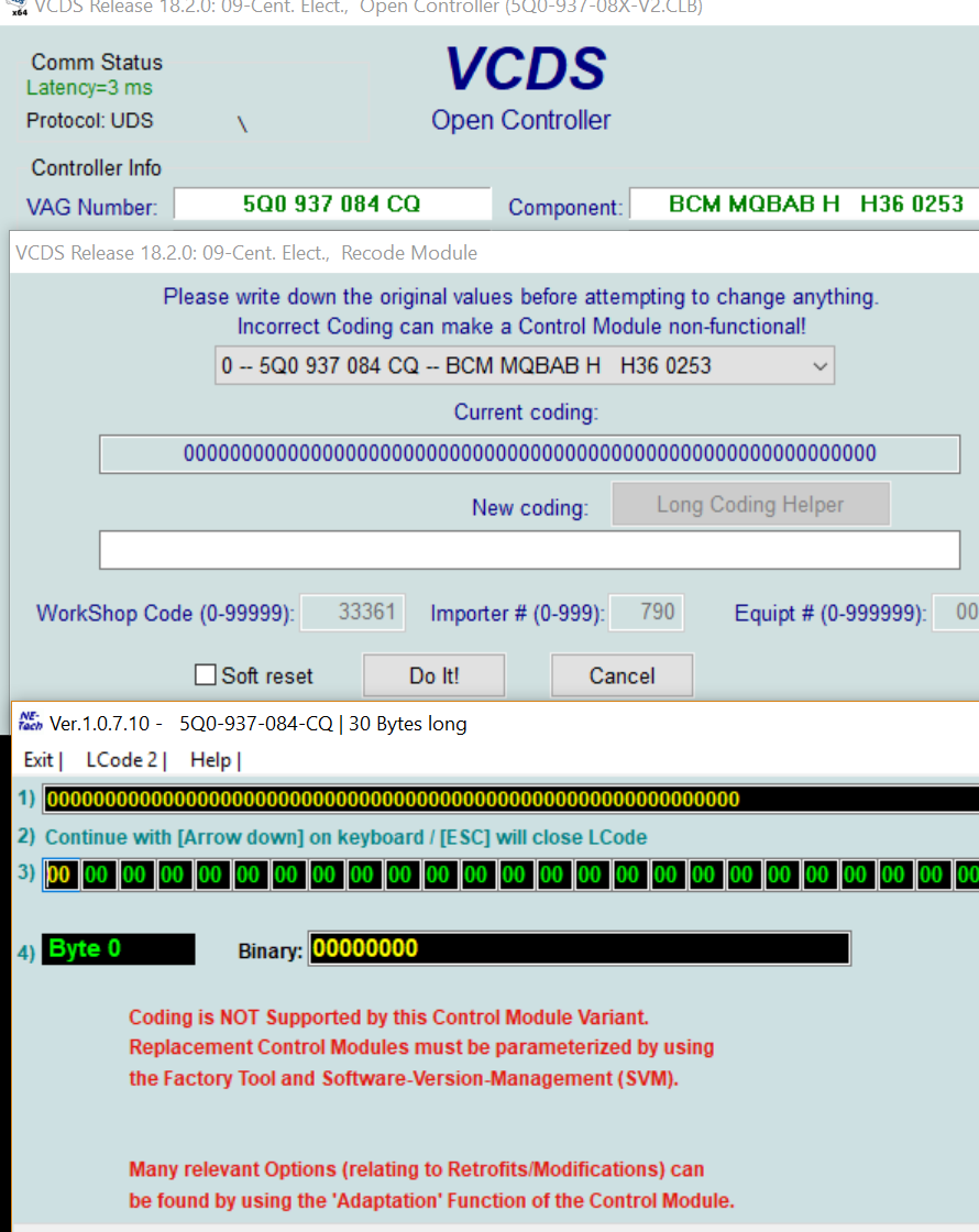

Can you try:
Controller 07 -> Coding -> Long coding -> press lcode2, a new window will open up with all the bytes. In byte 0 find bit 4.
And thank you very much for trying!!!
Edited by axd1152
I dont have Controller 07 - Its stated as not installed.

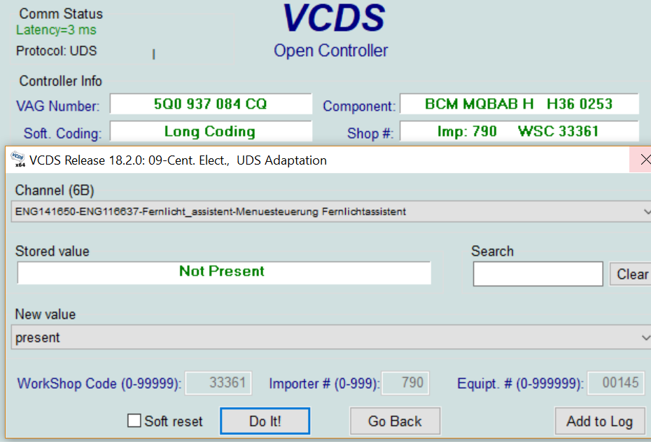

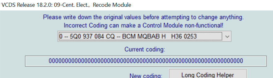

OK, so controller 09 adaptations all good.  controller A5, 07 coding good.   The problem I hit is controller 09 and the 07 coding for byte 3, bit 2.   When i go into the coding I see:
In the second dialog dropdown that says '0 - 5Q... etc', the other options are shown in my previous post.   Shows that its not supported, hence "07 Coding, byte 3 bit 2" doesnt make sense to me.

All coding is in the adaption channels on new BCM’s.

So, if that's the case, I am missing a setting somewhere.   I have
Controller 09, Adaptations 10:
ENG10578-ENG116637-Fernlicht_assistent-Menuesteuerung Fernlichtassistent adapted from "Not Present" to "present"
ENG10578-ENG116641-Fernlicht_assistent-Menuesteuerung Fernlichtassistent Werkseinstellung adapted from "Not Present" to "present"
ENG10578-ENG10901-Fernlicht_assistent-Erweiterte_Fernlichtsteuerung - AFS: BCM-Fernlicht Erweiterte_Fernlichtsteuerung auf "AFS: FLA: BCM-Fernlicht" setzen
