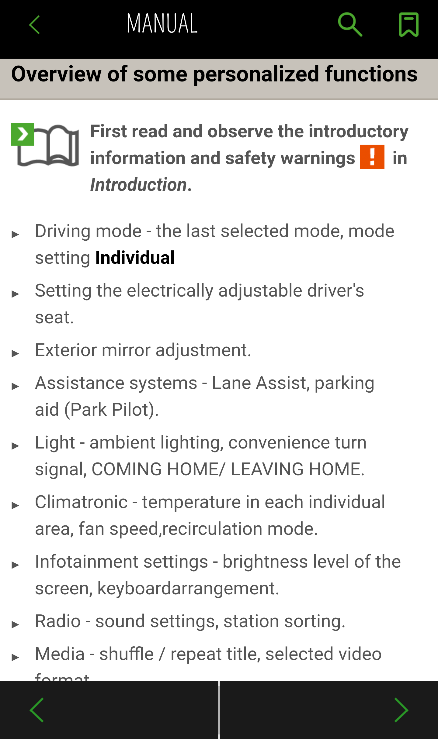

it's in the manual - under "personalization".
just like radio stations, seat positions, ambient lighting, etc etc, the driver assists settings are stored for each user.
as long as the feature is turned on, and the key is assigned to a user, the car will remember the setting each time u hope in.
for example, i have the driver assists (like Front Assist, Lane Assist) turned on when i hope in the car, but when my wife hops in, they are deactivated, cause she doesn't like it.
the image below, from the user manual, shows wat settings are affected by pesonalization, including the "Assistance systems".

As JR RS says, the option to remember many of the settings is a function of Personalisation.
You need to enable Personalisation, give yourself a name, assign your profile to your key, and then it should remember and reapply the settings every time you use that key.
