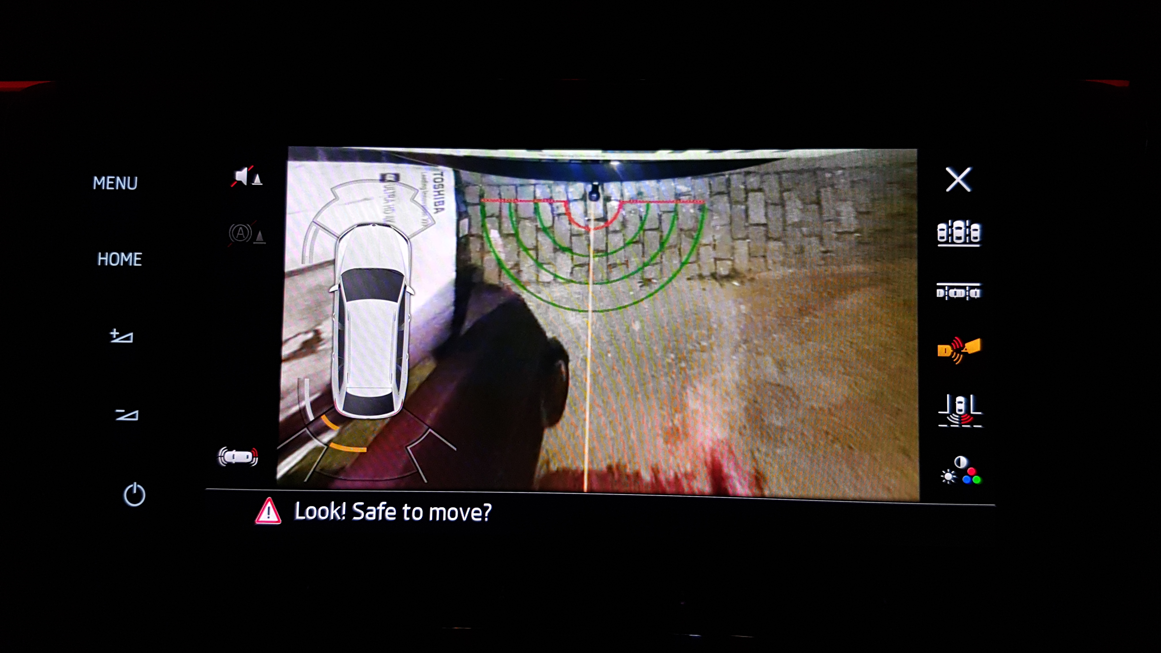

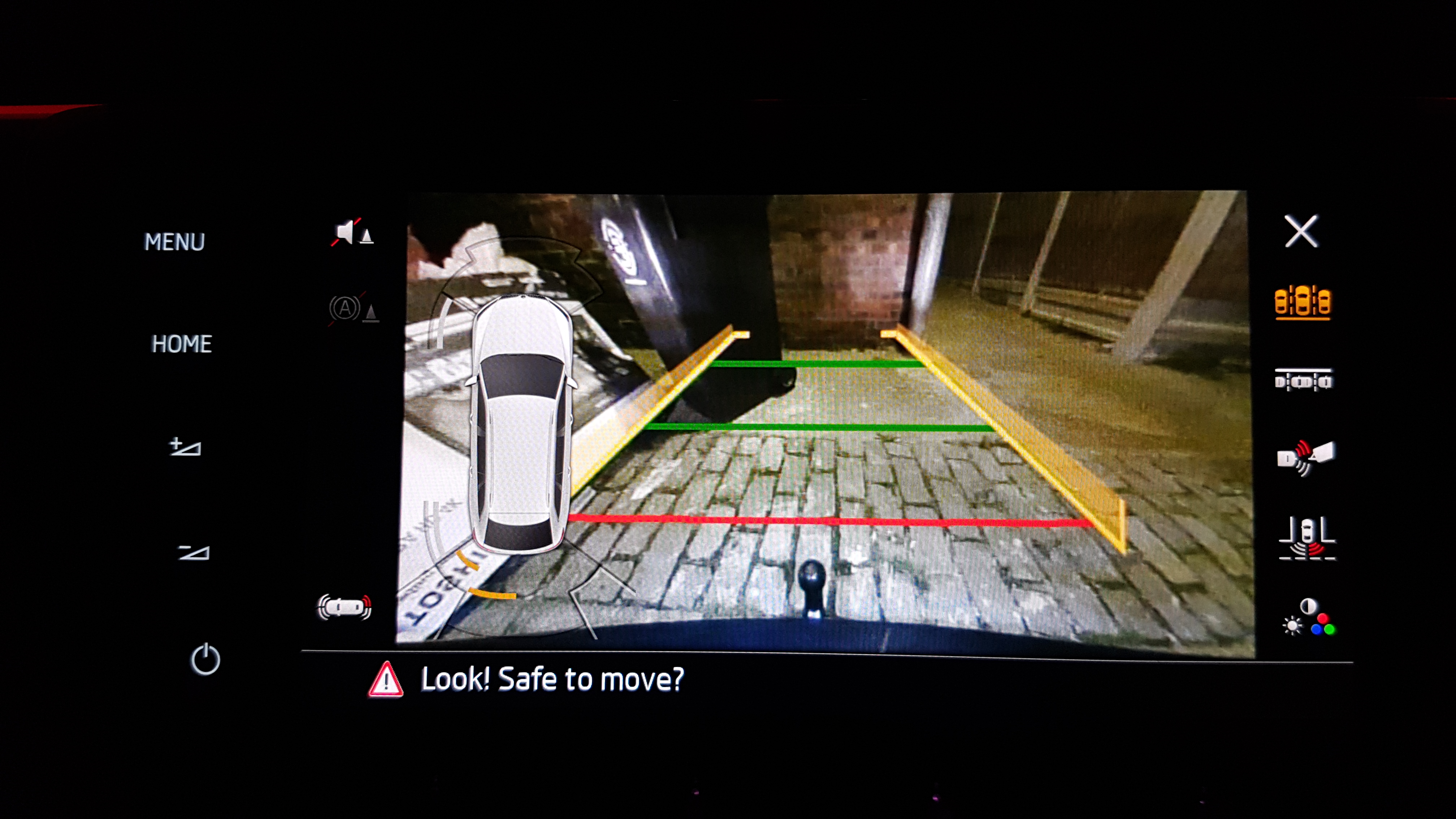

So I found this on youtube, after finding the activate central console button closing the rear tailgate. Is it possible to code this with VCDS or VAG CAN on a new UK car, dealer says there are no plans to have Trailer Assist on the Superb any time soon.
Now I have got the new car, thought I would update on what I have in the car. I have the integrated towbar and rear view camera but yet to see if this is can actually give me full trailer assist. Pressing the trailer option just changes the camera angle.
You need PLA, RVC High (and the towbar) to get Trailer Assist.

11 hours ago, zei20t said:
do you know anyone who can activate this?
Yes, in Denmark :) PLA (ParkAssist) and RVC High (Rear Video Cam) is not coding, but harware.
I have all of those, but was told by the dealer before the car arrived that Trailer Assist wasn't available on the Superb (in the UK at least) for another year.
you need to have the trailer attached for parking assist to work. once you are in reverse, hit the PLA button and see what happens.

I assume zei20t has worked out by now that the icon/button for the rear view camera and trailer is not trailer assist. It's a mode helping you reverse up to a trailer to hitch it up to the car. It's not what you get in say VW.
You'd hope the MQB platform meant it was possible but VW always keeps some technology for itself. Look at the active info display which is not yet available in Skoda or SEAT cars.
