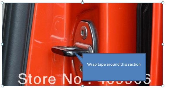

Try wrapping some electrical tape around the silver metal door latch that is affixed to the bodywork.  I had a very annoying rattle from my previous Superb.  It went back to the dealer twice, they remove and refitted the door trims and adjusted the locks bit it was only when I wrapped tape around the door latch that the noise disappeared.
Glen
Thanks for the advice, seems like a good idea ! Would you have a picture of how it looked ?

Hello Wilvern
I don't have a photo of my fix (it was on my previous Superb and the current car is rattle free currently), but I've grabbed a stock photo off the web and added a call-out to show where I wrapped the tape:
Hope that helps!
Hope that helps!
Glen
Nice, thanks a lot Glen :)

Glen Thanks for the post I had the same problem as yo. I don't know how but this has fixed the problem for me
