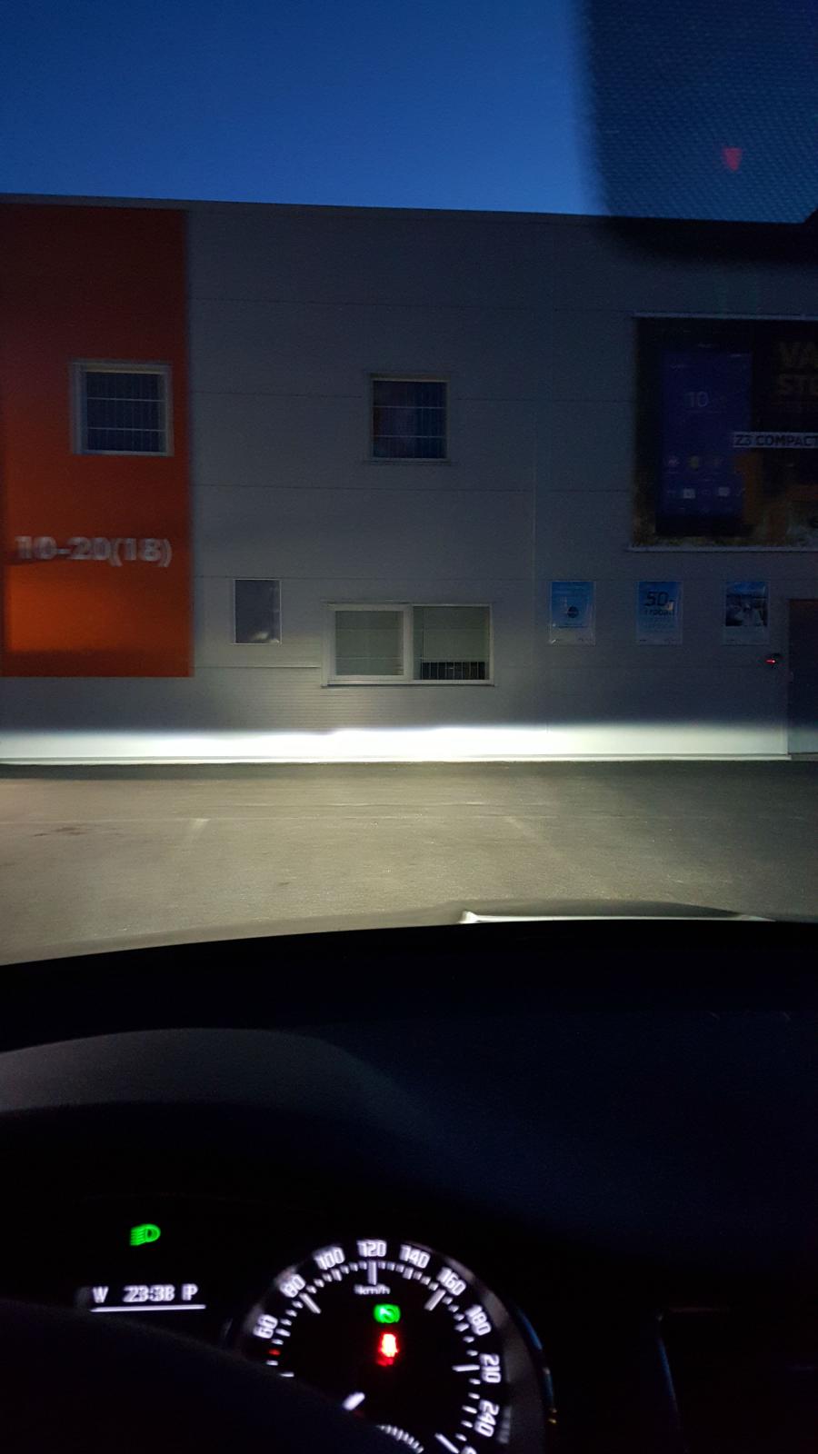

Adding a picture of my S2 FL cutoff.. I don't know what u think about it:

Your cutoff isn't to bad but it isn't sharp and clear. A FX-R 3.0 retro fit would be great but you would need to take the headlight apart first and do some measurements. The FXR does have quite a big casing all the way to the lens so that would be your biggest difficulty.

I know the cutoff is ok.. But FAR away from crispy and clear.
