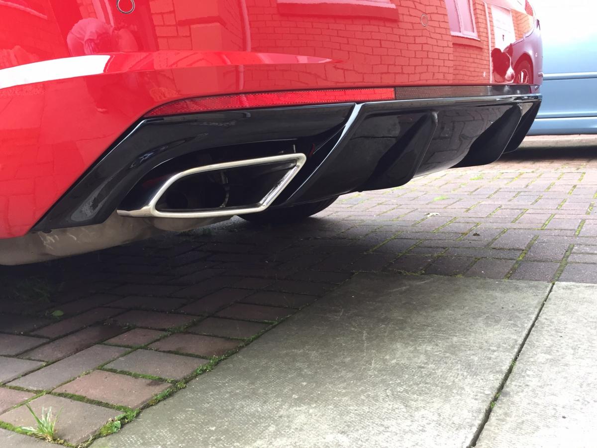

Just fitted the rieger rear diffuser to my vrs and am delighted with it thanks to Steve (h3srr) for the info on where to get it from

Here's the pics didn't work on original post
Looks good.
Yeah pretty easy original one comes off with removing the seven screws and then I just used a plastic trim removal tool to pop the retaining lugs along the top next to the reflector strip just look at the rieger one to judge where the lugs are and wedge them down and they pop out you have to drill a hole in the bumper on the passenger side near were the mud flap is for the screw to go in but fairly easy took me about 30 mins to fit it

Looks good op, but I don't feel it moves the game on that much from the oem diffuser, tbh, sorry, just an observation..

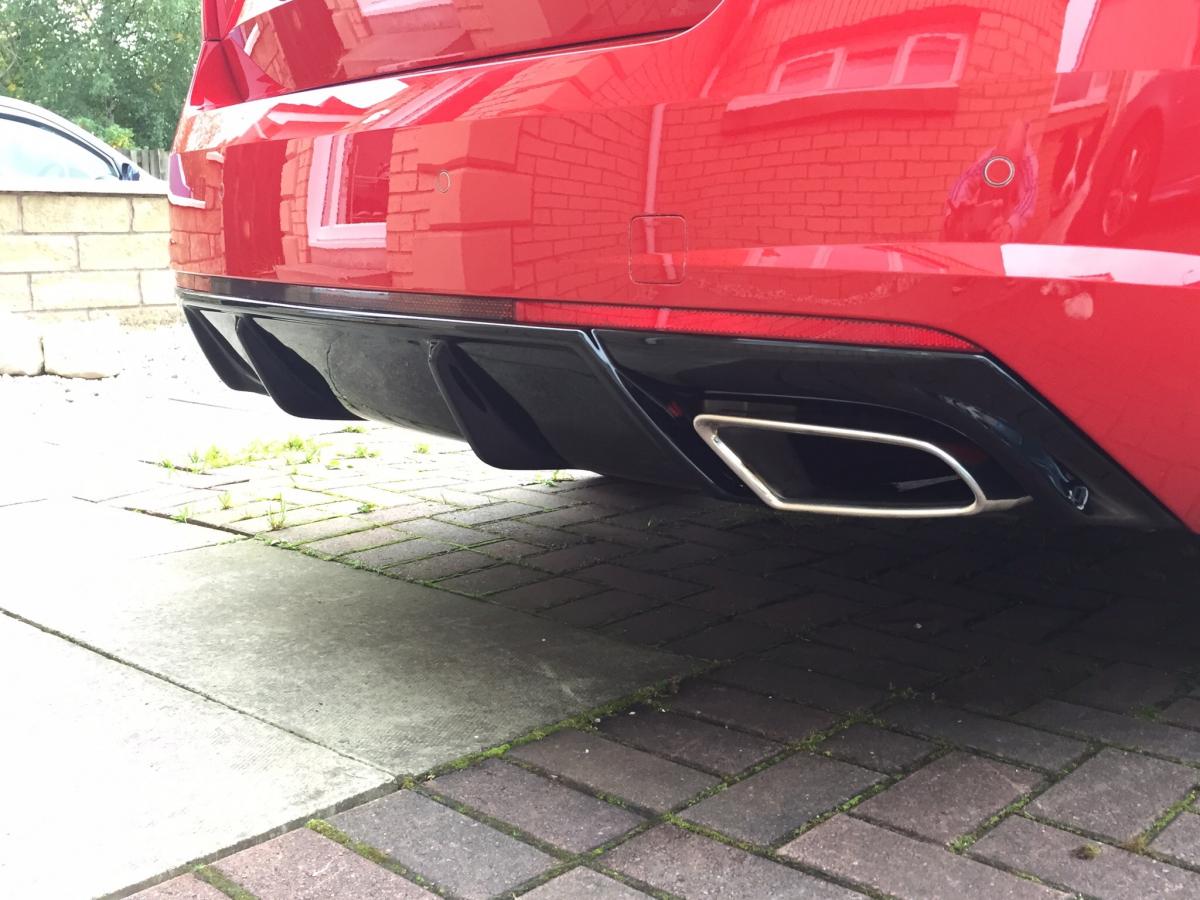

Just found this thread. Is that how the deflectors come on the Reiger diffuser? I ordered mine yesterday just waiting for it to arrive. Hopefully an easy fit.

It's even better when both exhausts work, as per:-
