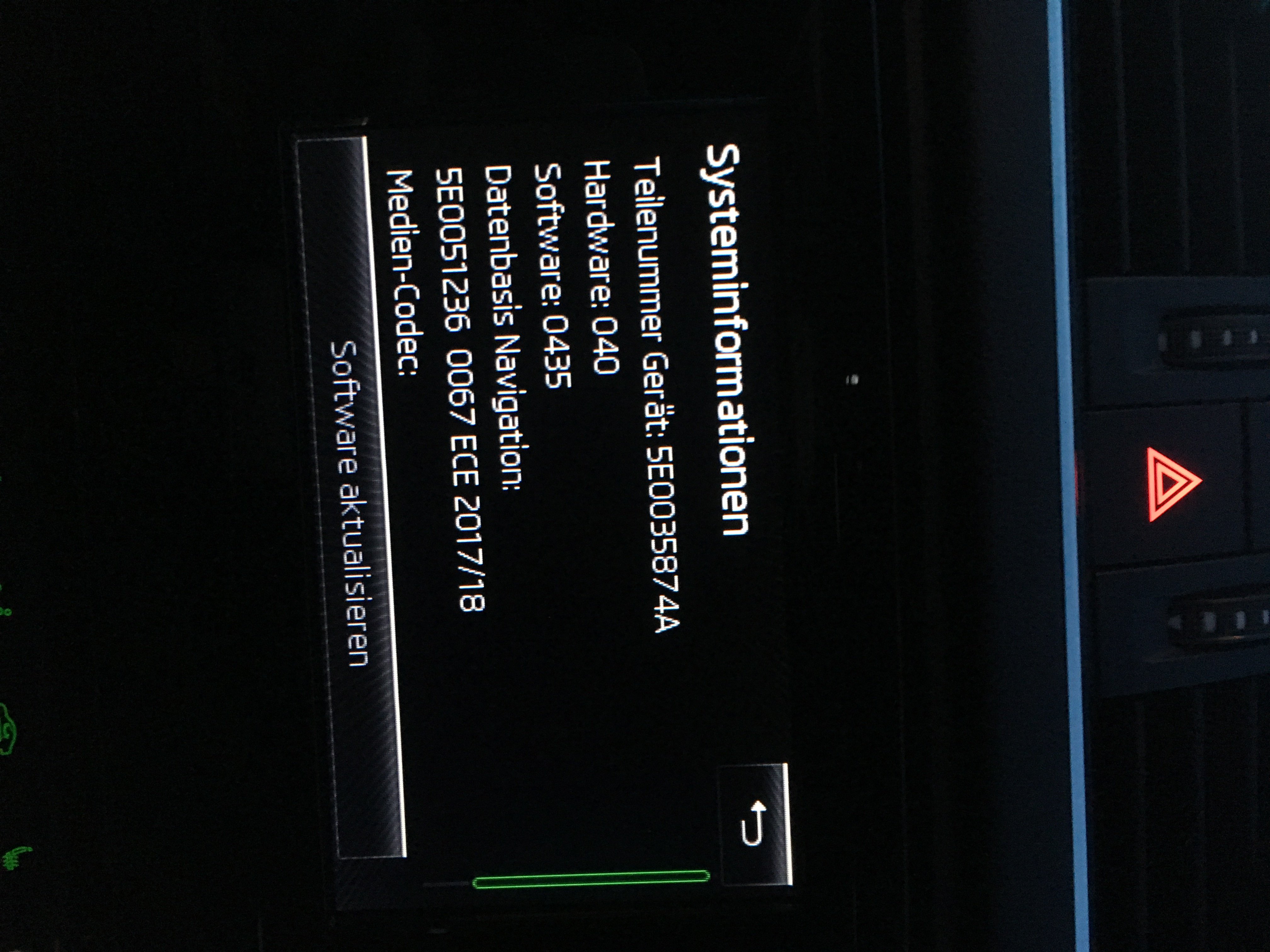

Good evening,
I would appreciate if someone could send me the link for an update as well!
Hardware 041
Software 0465
Device part 5e0035874a
Thanks a lot

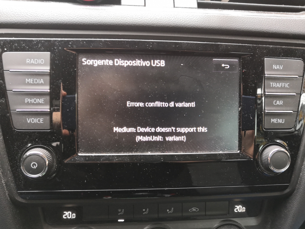

Error
why?
Help me
Tnx

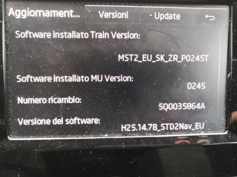

@buarotti are you sure it's amundsen + mib1, not bolero + mib2?
Amundsen (Octavia Wagon Executive  7/2016)
Are you sure it's a MIB1 Amundsen and not a MIB2 Amundsen? It looks like a MIB2 to me...
That's a MIB2 Amundsen, this thread is for updating MIB1 units...

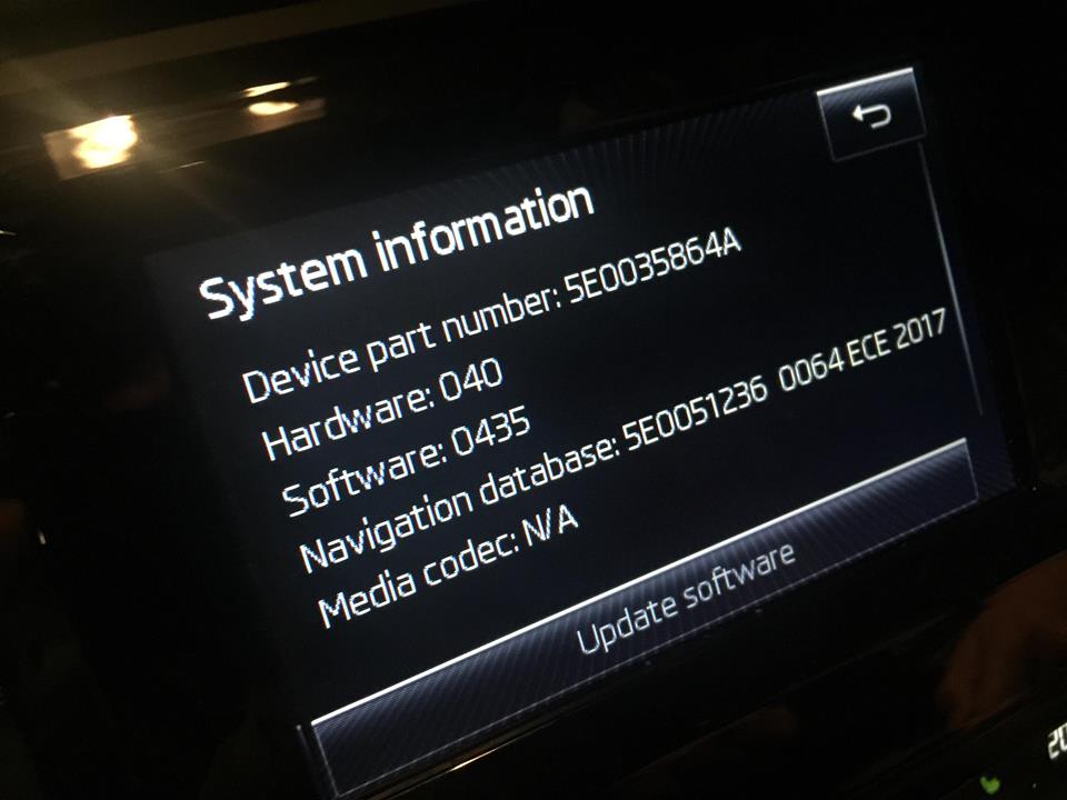

On ‎11‎/‎11‎/‎2015 at 19:48, rdb said:
Would be interested to know what firmware others have in Amundsen MIB1.
Mine is
Device 5E0035874A
Hardware version: 040
Firmware version: 0435
This is in an August 2014 Built L&K with Canton.
Problems I have are poor zooming on navigation and restricted power output on all audio sources.
Asked a well known West Yorkshire dealer to check for software update at 12 month service. Told there are none
Before I follow up just wanted to find out if there is a later firmware than 0435
Thanks
