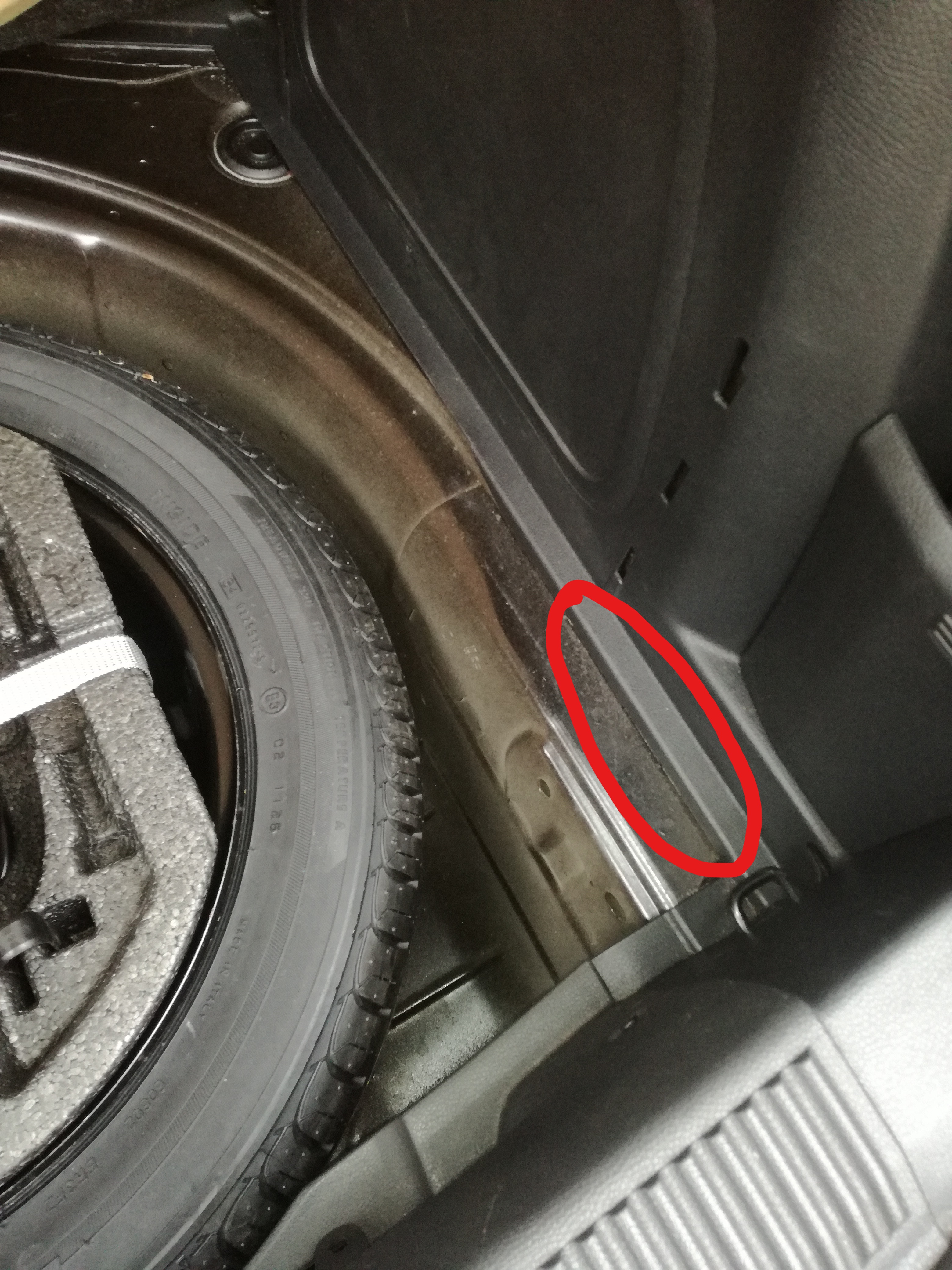

I know this is an old topic, but how does the water get into the wheel well without soaking the boot carpet?
I opted for the hole in the grommet fix on my pd3 estate.
No rear end interactions have taken place and it'd been fine and dry for 4 1/2 yers 'til recently?
well in my case the water would enter from the vent shown in the pictures above, and would enter the wheel well from under this plastic on the side
